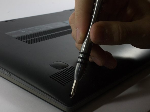

    • Start by removing the feet near the LCD hinge of the laptop to reveal two screws.
    • Using a Phillips #1 screwdriver, remove the top five (30 mm) screws underneath the battery.

    • Once both feet are removed, two (40 mm) screws will reveal themselves. Unscrew these.

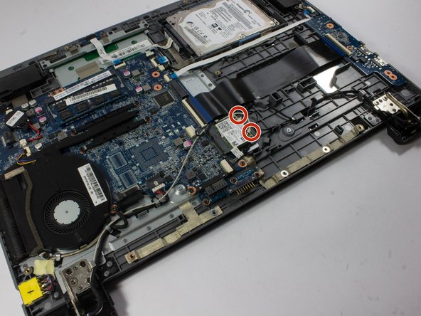

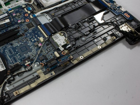

  7. Lenovo Ideapad Flex 15 Wireless Networking Card Replacement, Wireless Networking Card: crwdns2935265:07crwdnd2935265:01crwdnd2935265:02crwdne2935265:0 Lenovo Ideapad Flex 15 Wireless Networking Card Replacement, Wireless Networking Card: crwdns2935265:07crwdnd2935265:02crwdnd2935265:02crwdne2935265:0
    • Locate the wireless card. It is located above the black ribbon cable, underneath the battery terminals.
    • The wireless card has two antennas (black and white cables) that are attached to other parts of the laptop.

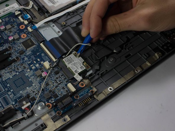

  8. Lenovo Ideapad Flex 15 Wireless Networking Card Replacement: crwdns2935265:08crwdnd2935265:01crwdnd2935265:02crwdne2935265:0 Lenovo Ideapad Flex 15 Wireless Networking Card Replacement: crwdns2935265:08crwdnd2935265:02crwdnd2935265:02crwdne2935265:0
    • To remove these cables, take your plastic opening tool and gently pry around the metal base above the PCB until the connectors are freed.
    • Repeat this step with both the black and the white antennas

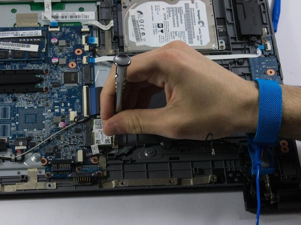

  9. Lenovo Ideapad Flex 15 Wireless Networking Card Replacement: crwdns2935265:09crwdnd2935265:01crwdnd2935265:03crwdne2935265:0 Lenovo Ideapad Flex 15 Wireless Networking Card Replacement: crwdns2935265:09crwdnd2935265:02crwdnd2935265:03crwdne2935265:0 Lenovo Ideapad Flex 15 Wireless Networking Card Replacement: crwdns2935265:09crwdnd2935265:03crwdnd2935265:03crwdne2935265:0
    • There are two (30 mm) screws attached to the wireless card underneath the antenna. Remove both of these with your screwdriver (bit PH1).
    • Once the screws are removed, the wireless card will tilt upwards. Firmly grab the card with one hand and pull it slowly, diagonally, out of the socket.

  10. Lenovo Ideapad Flex 15 Wireless Networking Card Replacement: crwdns2935265:010crwdnd2935265:01crwdnd2935265:03crwdne2935265:0 Lenovo Ideapad Flex 15 Wireless Networking Card Replacement: crwdns2935265:010crwdnd2935265:02crwdnd2935265:03crwdne2935265:0 Lenovo Ideapad Flex 15 Wireless Networking Card Replacement: crwdns2935265:010crwdnd2935265:03crwdnd2935265:03crwdne2935265:0
    • To seat the wireless card, put the two screws back into the card. It should be flush against the base of the laptop.
    • Line up the white antenna back in the original (left) terminal. Push the antenna gently onto the wireless adapter with one finger. Give it a small tug to ensure it is connected firmly.
    • Do the same with the black antenna, snapping it onto the right antenna port.
