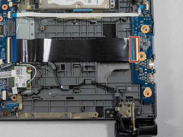

  7. Lenovo Ideapad Flex 15 USB Header Adaptor Replacement, USB Header Adaptor: crwdns2935265:07crwdnd2935265:01crwdnd2935265:02crwdne2935265:0 Lenovo Ideapad Flex 15 USB Header Adaptor Replacement, USB Header Adaptor: crwdns2935265:07crwdnd2935265:02crwdnd2935265:02crwdne2935265:0
    • Locate the large blue circuit board on the leftmost side of the Flex 15.
    • This board is connected in two ways, by both a screw and a ribbon cable.
  8. Lenovo Ideapad Flex 15 USB Header Adaptor Replacement: crwdns2935265:08crwdnd2935265:01crwdnd2935265:02crwdne2935265:0 Lenovo Ideapad Flex 15 USB Header Adaptor Replacement: crwdns2935265:08crwdnd2935265:02crwdnd2935265:02crwdne2935265:0
    • The large black ribbon cable is attached to a header. With a blue opening tool, flip up the ZIF (zero insertion force) connector, then pry the header from a 0 degree angle to a 90 degree angle. Be sure not to snap the header while doing it, it is very delicate.
    • Once the ribbon cable is freed, gently pull it out of the header.

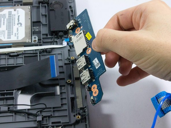

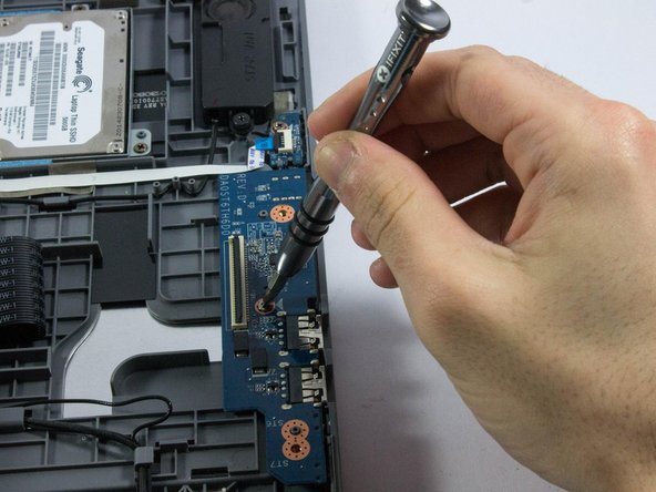

  9. Lenovo Ideapad Flex 15 USB Header Adaptor Replacement: crwdns2935265:09crwdnd2935265:01crwdnd2935265:02crwdne2935265:0 Lenovo Ideapad Flex 15 USB Header Adaptor Replacement: crwdns2935265:09crwdnd2935265:02crwdnd2935265:02crwdne2935265:0
    • Locate the (20 mm) screws with the orange ring and the arrow on the PCB pointing to it. Remove these screws.
    • Once freed, pull the assembly upwards, away from the computer.
