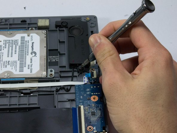

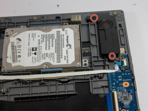

  7. Lenovo Ideapad Flex 15 Speaker Replacement, Speaker: crwdns2935265:07crwdnd2935265:01crwdnd2935265:03crwdne2935265:0 Lenovo Ideapad Flex 15 Speaker Replacement, Speaker: crwdns2935265:07crwdnd2935265:02crwdnd2935265:03crwdne2935265:0 Lenovo Ideapad Flex 15 Speaker Replacement, Speaker: crwdns2935265:07crwdnd2935265:03crwdnd2935265:03crwdne2935265:0
    • Locate the speaker unit at the top left hand corner of the Flex 15.
    • Using the screwdriver (PH1 bit), remove the (50 mm) screws on either side of the speaker unit.
  8. Lenovo Ideapad Flex 15 Speaker Replacement: crwdns2935265:08crwdnd2935265:01crwdnd2935265:02crwdne2935265:0 Lenovo Ideapad Flex 15 Speaker Replacement: crwdns2935265:08crwdnd2935265:02crwdnd2935265:02crwdne2935265:0
    • There is a small white socket which a cable of the speakers is plugged into.
    • Pull the wire off by pulling either sides of the black header (do not pull the wire directly as it could break off).
    • The speaker can be removed carefully.
