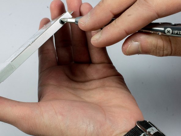

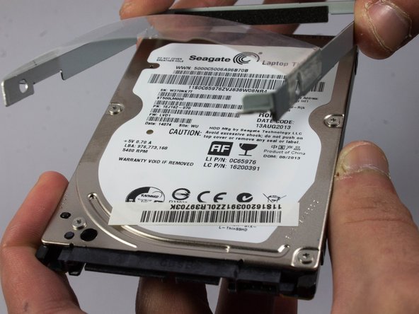

  9. Lenovo Ideapad Flex 15 Hard Drive Replacement: crwdns2935265:09crwdnd2935265:01crwdnd2935265:03crwdne2935265:0 Lenovo Ideapad Flex 15 Hard Drive Replacement: crwdns2935265:09crwdnd2935265:02crwdnd2935265:03crwdne2935265:0 Lenovo Ideapad Flex 15 Hard Drive Replacement: crwdns2935265:09crwdnd2935265:03crwdnd2935265:03crwdne2935265:0
    • The hard drive should be freed from the base of the laptop.
    • There are four (20 mm) black screws surrounding the hard drive from the cage. Unscrew these to free the hard drive from the cage
