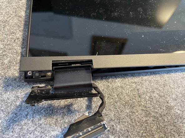

  3. Lenovo Ideapad C340-API or Flex 14-API webcam repair, Screen hinge left: crwdns2935265:03crwdnd2935265:01crwdnd2935265:02crwdne2935265:0 Lenovo Ideapad C340-API or Flex 14-API webcam repair, Screen hinge left: crwdns2935265:03crwdnd2935265:02crwdnd2935265:02crwdne2935265:0
    • Unscrew the left screen hinge with a screwdriver.

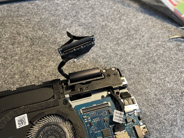

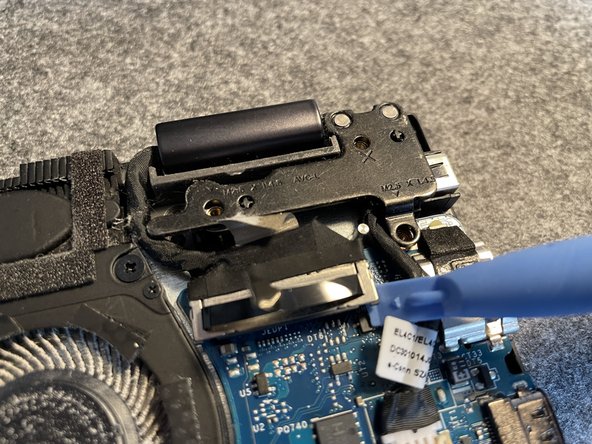

  4. Lenovo Ideapad C340-API or Flex 14-API webcam repair, Right screen hinge and display connector: crwdns2935265:04crwdnd2935265:01crwdnd2935265:03crwdne2935265:0 Lenovo Ideapad C340-API or Flex 14-API webcam repair, Right screen hinge and display connector: crwdns2935265:04crwdnd2935265:02crwdnd2935265:03crwdne2935265:0 Lenovo Ideapad C340-API or Flex 14-API webcam repair, Right screen hinge and display connector: crwdns2935265:04crwdnd2935265:03crwdnd2935265:03crwdne2935265:0
    • Unscrew the two screws of the right screen hinge
    • Unplug the display connector carefully using a spudger from the right side

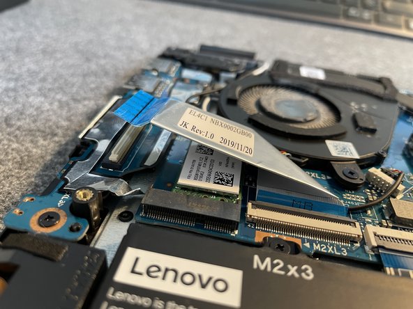

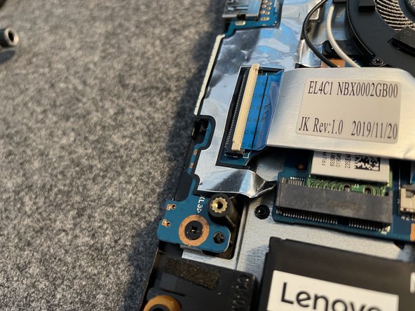

  5. Lenovo Ideapad C340-API or Flex 14-API webcam repair, Disconnect the extension board: crwdns2935265:05crwdnd2935265:01crwdnd2935265:03crwdne2935265:0 Lenovo Ideapad C340-API or Flex 14-API webcam repair, Disconnect the extension board: crwdns2935265:05crwdnd2935265:02crwdnd2935265:03crwdne2935265:0 Lenovo Ideapad C340-API or Flex 14-API webcam repair, Disconnect the extension board: crwdns2935265:05crwdnd2935265:03crwdnd2935265:03crwdne2935265:0
    • The extension board to the left is connected by a ribbon cable.
    • To unplug it lift up the white clip and carefully pull out the cable

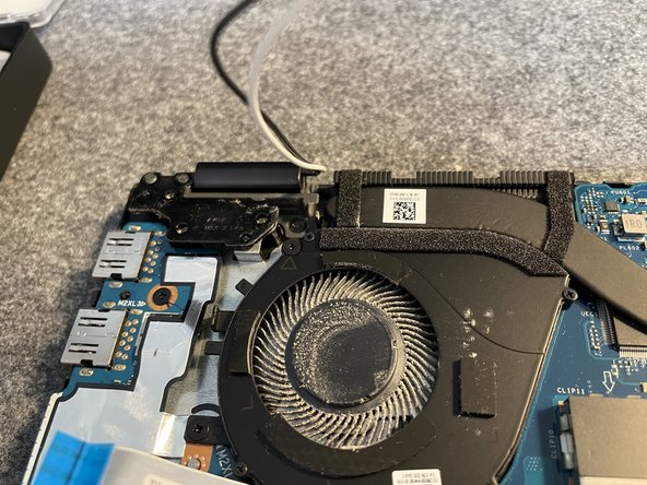

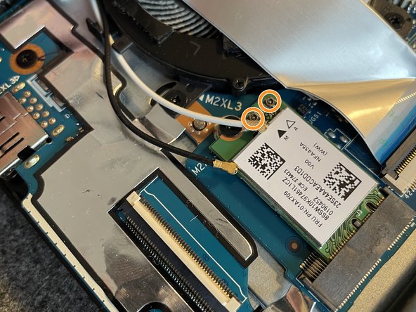

  6. Lenovo Ideapad C340-API or Flex 14-API webcam repair, Unplug the Wi-Fi card: crwdns2935265:06crwdnd2935265:01crwdnd2935265:03crwdne2935265:0 Lenovo Ideapad C340-API or Flex 14-API webcam repair, Unplug the Wi-Fi card: crwdns2935265:06crwdnd2935265:02crwdnd2935265:03crwdne2935265:0 Lenovo Ideapad C340-API or Flex 14-API webcam repair, Unplug the Wi-Fi card: crwdns2935265:06crwdnd2935265:03crwdnd2935265:03crwdne2935265:0
    • Depending on your model the two wifi connectors may be hidden under a soft rubber pad. Remove it with a pair of tweezers.
    • You can use the tweezers to lift up the wifi connectors from its plug. Be careful not to damage the cables in the process.

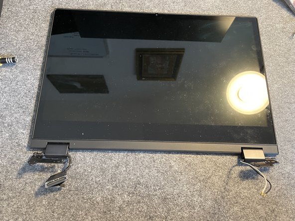

  7. Lenovo Ideapad C340-API or Flex 14-API webcam repair, Display removal: crwdns2935265:07crwdnd2935265:01crwdnd2935265:02crwdne2935265:0 Lenovo Ideapad C340-API or Flex 14-API webcam repair, Display removal: crwdns2935265:07crwdnd2935265:02crwdnd2935265:02crwdne2935265:0
    • With all cables and connectors removed from the main board you can now gently lift up the hinges and separate display assembly from the rest.
    • Now you have the display assembly only which gives you way easier access to further repairs.

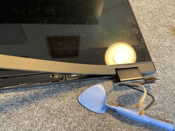

  8. Lenovo Ideapad C340-API or Flex 14-API webcam repair, Screen disassembly: crwdns2935265:08crwdnd2935265:01crwdnd2935265:03crwdne2935265:0 Lenovo Ideapad C340-API or Flex 14-API webcam repair, Screen disassembly: crwdns2935265:08crwdnd2935265:02crwdnd2935265:03crwdne2935265:0 Lenovo Ideapad C340-API or Flex 14-API webcam repair, Screen disassembly: crwdns2935265:08crwdnd2935265:03crwdnd2935265:03crwdne2935265:0

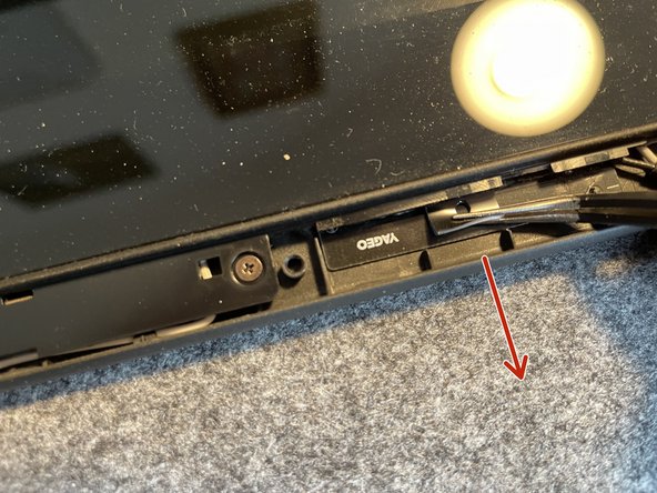

    • Pry off the flexible bottom cover of the display assembly.
    • You can use a spudger or a guitar pick to do so.
  9. Lenovo Ideapad C340-API or Flex 14-API webcam repair: crwdns2935265:09crwdnd2935265:01crwdnd2935265:03crwdne2935265:0 Lenovo Ideapad C340-API or Flex 14-API webcam repair: crwdns2935265:09crwdnd2935265:02crwdnd2935265:03crwdne2935265:0 Lenovo Ideapad C340-API or Flex 14-API webcam repair: crwdns2935265:09crwdnd2935265:03crwdnd2935265:03crwdne2935265:0
    • With the cover removed you will find 4 screws to be removed (red circles) as well as two strips of adhesive (green rectangles) you have to pull.
    • After unscrewing the four screws use a pair of tweezers to pull on the tabs of the rubber adhesive strips.
    • Be patient while pulling and avoid ripping off the adhesive strips!

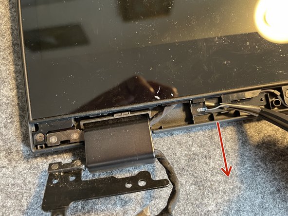

  10. Lenovo Ideapad C340-API or Flex 14-API webcam repair, Webcam removal: crwdns2935265:010crwdnd2935265:01crwdnd2935265:03crwdne2935265:0 Lenovo Ideapad C340-API or Flex 14-API webcam repair, Webcam removal: crwdns2935265:010crwdnd2935265:02crwdnd2935265:03crwdne2935265:0 Lenovo Ideapad C340-API or Flex 14-API webcam repair, Webcam removal: crwdns2935265:010crwdnd2935265:03crwdnd2935265:03crwdne2935265:0
    • After you have removed the adhesive the display can be separated from its housing. Be careful with handling as the touchscreen is quite fragile
    • To proceed you have to unplug the ribbon cables like you did before on the mainboard.
    • Lift up the tabs and pull out the cables.

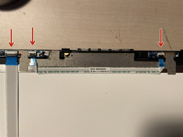

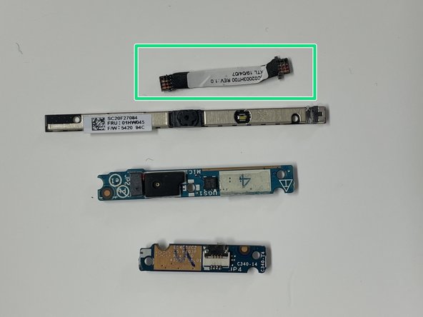

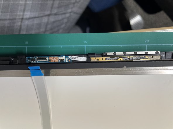

  11. Lenovo Ideapad C340-API or Flex 14-API webcam repair, Inspecting the logical boards: crwdns2935265:011crwdnd2935265:01crwdnd2935265:02crwdne2935265:0 Lenovo Ideapad C340-API or Flex 14-API webcam repair, Inspecting the logical boards: crwdns2935265:011crwdnd2935265:02crwdnd2935265:02crwdne2935265:0
    • After removing the adhesive strip you can see that the webcam is divided into 3 logical units:
    • The first board (green rectangle) houses the indicator LED as well as the microphone. The second board (blue rectangle) is just the webcam with the part no. 01HW045. The smallest (red rectangle) seems to be a light sensor board
    • The boards are just glued into place and can easily be pryed out.

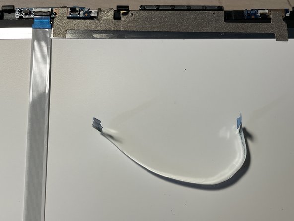

  12. Lenovo Ideapad C340-API or Flex 14-API webcam repair, Tinkering and reseating: crwdns2935265:012crwdnd2935265:01crwdnd2935265:03crwdne2935265:0 Lenovo Ideapad C340-API or Flex 14-API webcam repair, Tinkering and reseating: crwdns2935265:012crwdnd2935265:02crwdnd2935265:03crwdne2935265:0 Lenovo Ideapad C340-API or Flex 14-API webcam repair, Tinkering and reseating: crwdns2935265:012crwdnd2935265:03crwdnd2935265:03crwdne2935265:0
    • The connectors between the boards especially the ribbon cable (green rectangle) lose connection over time. This is why problems occur.
    • To fix just reseat all connectors carefully!
    • If you bought a webcam replacement just connect all cables as they were before.
    • I used duct tape to create a stronger bond between the components.
You might use double sided tape to glue the display back to its frame.
