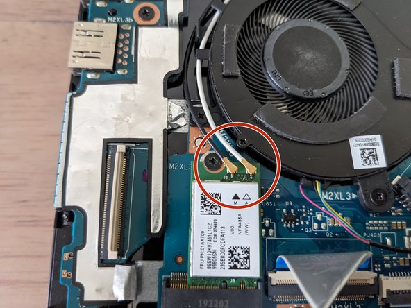

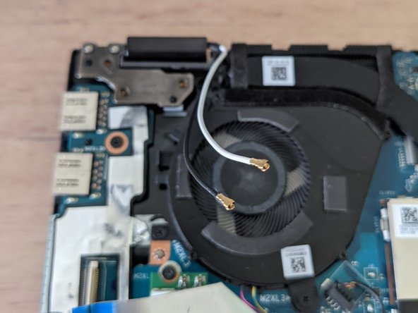

  4. Lenovo Ideapad C340-API or Flex 14-API Display Assembly Replacement, WiFi antennae and power button board: crwdns2935265:04crwdnd2935265:01crwdnd2935265:03crwdne2935265:0 Lenovo Ideapad C340-API or Flex 14-API Display Assembly Replacement, WiFi antennae and power button board: crwdns2935265:04crwdnd2935265:02crwdnd2935265:03crwdne2935265:0 Lenovo Ideapad C340-API or Flex 14-API Display Assembly Replacement, WiFi antennae and power button board: crwdns2935265:04crwdnd2935265:03crwdnd2935265:03crwdne2935265:0
    • Locate the folded ribbon cable on the bottom left which connects the motherboard to the smaller power button board.
    • Release the ribbon cable to the right by lifting up the white part of the connector carefully. It should look just like in the photo. Now you can pull out the cable and have view at the WiFi card.
    • The WiFi card has antenna connectors to the screen and need to be disconnected. Locate the brazen connectors (red circle) and really gently disconnect them by using your fingernails or a spudger.

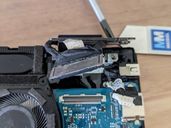

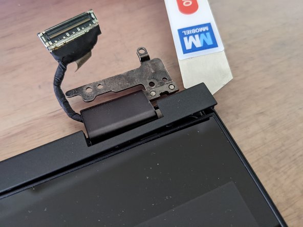

  5. Lenovo Ideapad C340-API or Flex 14-API Display Assembly Replacement, Disconnect the screen connector: crwdns2935265:05crwdnd2935265:01crwdnd2935265:02crwdne2935265:0 Lenovo Ideapad C340-API or Flex 14-API Display Assembly Replacement, Disconnect the screen connector: crwdns2935265:05crwdnd2935265:02crwdnd2935265:02crwdne2935265:0
    • Last but not least you have to disconnect the display from the motherboard in the upper right corner of the Ideapad.
    • There is an adhesive strip which should allow you to lift the connector from the board. Unfortunately mine ripped off in the process but you can use a spudger if you're careful. It is really firm in place so you might want to be careful not to damage anything.
    • Now everything that connected the screen to the motherboard or assembly is loose and we're ready to take off the display.

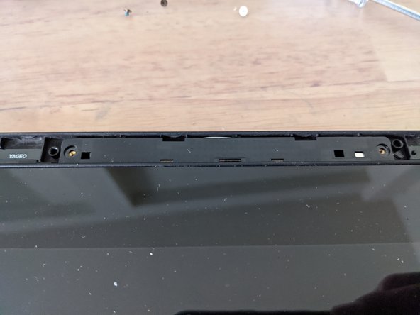

    • Here is your touch display.
    • If you would like to go further like replacing the webcam in your display you'd have to move on by removing the bottom plastic strip with a spudger.
    • The display is glued to the A-Cover and requires further steps to accomplish.
