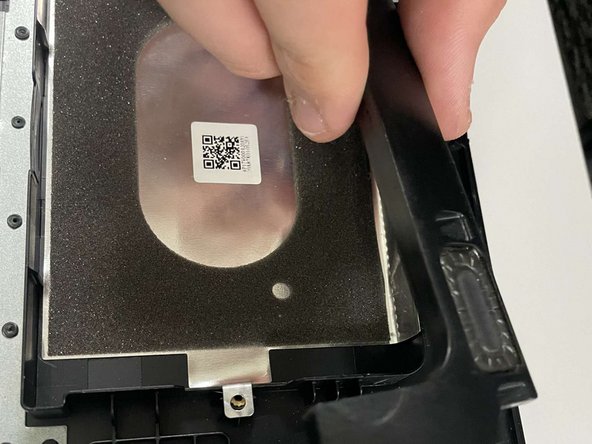

  1. Lenovo Ideapad 330-15ARR Speaker Replacement, Lower Case: crwdns2935265:01crwdnd2935265:01crwdnd2935265:01crwdne2935265:0
    • Remove all Phillips #0 screws securing the case to the laptop.
  2. Lenovo Ideapad 330-15ARR Speaker Replacement: crwdns2935265:02crwdnd2935265:01crwdnd2935265:02crwdne2935265:0 Lenovo Ideapad 330-15ARR Speaker Replacement: crwdns2935265:02crwdnd2935265:02crwdnd2935265:02crwdne2935265:0
    • Pry all edges off of the laptop with the opening tool until the lower case releases.
    • Remove the lower case.

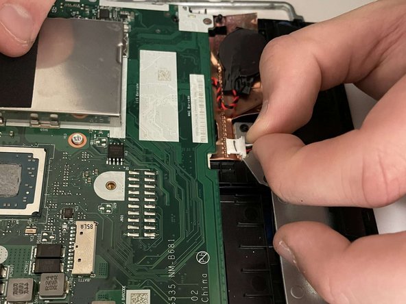

  3. Lenovo Ideapad 330-15ARR Speaker Replacement, Speaker: crwdns2935265:03crwdnd2935265:01crwdnd2935265:02crwdne2935265:0 Lenovo Ideapad 330-15ARR Speaker Replacement, Speaker: crwdns2935265:03crwdnd2935265:02crwdnd2935265:02crwdne2935265:0
    • Remove the speaker's motherboard connection.

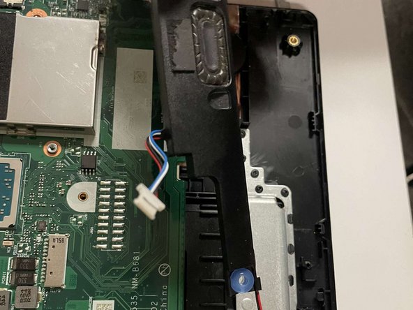

  4. Lenovo Ideapad 330-15ARR Speaker Replacement: crwdns2935265:04crwdnd2935265:01crwdnd2935265:03crwdne2935265:0 Lenovo Ideapad 330-15ARR Speaker Replacement: crwdns2935265:04crwdnd2935265:02crwdnd2935265:03crwdne2935265:0 Lenovo Ideapad 330-15ARR Speaker Replacement: crwdns2935265:04crwdnd2935265:03crwdnd2935265:03crwdne2935265:0
    • Each speaker has multiple plastic connection points - simply pull upwards and they should easily slide off of them.
    • Remove the speaker.
