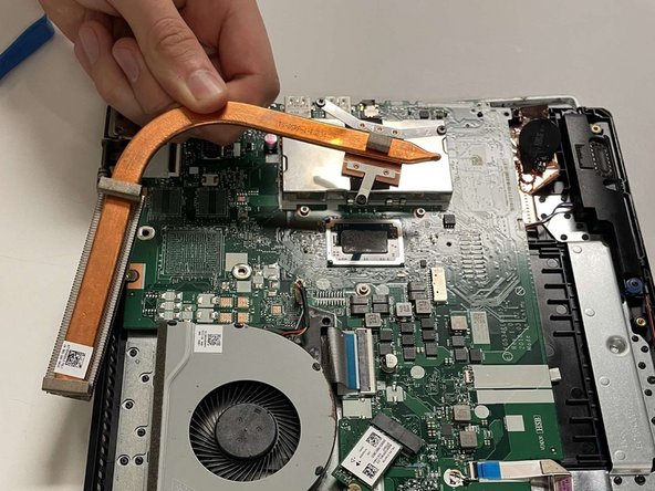

    • Unscrew all three captive screws attaching the heat sink to the motherboard with a Phillips #0 screwdriver.
    • These screws stay attached to the heatsink, so do not attempt to remove them.

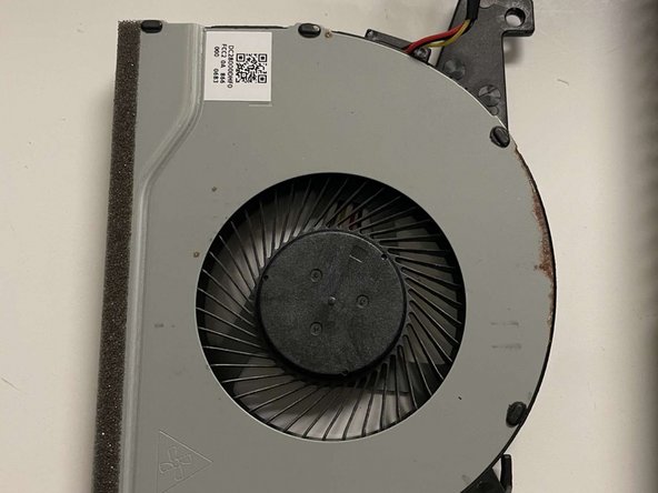

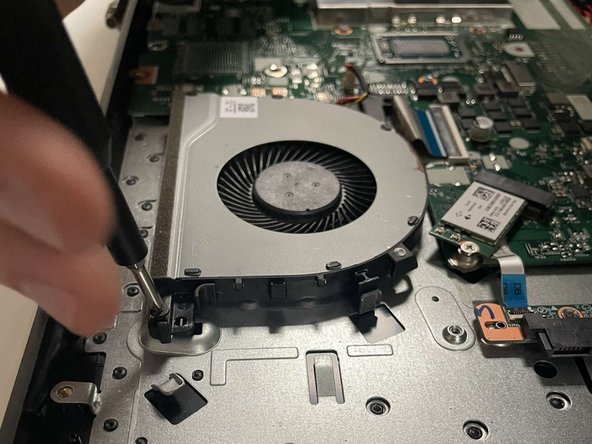

    • Remove the three Phillips #0 screws securing the fan assembly.
  5. Lenovo Ideapad 330-15ARR Fan Assembly Replacement: crwdns2935265:05crwdnd2935265:01crwdnd2935265:03crwdne2935265:0 Lenovo Ideapad 330-15ARR Fan Assembly Replacement: crwdns2935265:05crwdnd2935265:02crwdnd2935265:03crwdne2935265:0 Lenovo Ideapad 330-15ARR Fan Assembly Replacement: crwdns2935265:05crwdnd2935265:03crwdnd2935265:03crwdne2935265:0

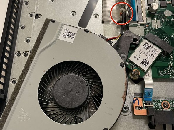

    • Take the wires in your hand, and firmly but gently pull it out of its port.
    • Lift the fan assembly out of the device.
