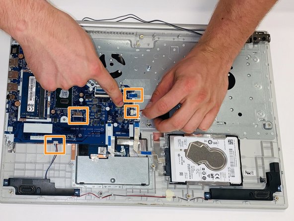

  11. Lenovo Ideapad 320-17IKB Motherboard Replacement, Motherboard: crwdns2935265:011crwdnd2935265:01crwdnd2935265:03crwdne2935265:0 Lenovo Ideapad 320-17IKB Motherboard Replacement, Motherboard: crwdns2935265:011crwdnd2935265:02crwdnd2935265:03crwdne2935265:0 Lenovo Ideapad 320-17IKB Motherboard Replacement, Motherboard: crwdns2935265:011crwdnd2935265:03crwdnd2935265:03crwdne2935265:0
    • Gently pull the blue ribbon marked with "MB" connectors.
    • Gently remove the other connectors in the picture by pulling them straight out.
    • Blue connectors encased in a black holder may require tweezers to unclasp the connector for removal.
  12. Lenovo Ideapad 320-17IKB Motherboard Replacement: crwdns2935265:012crwdnd2935265:01crwdnd2935265:03crwdne2935265:0 Lenovo Ideapad 320-17IKB Motherboard Replacement: crwdns2935265:012crwdnd2935265:02crwdnd2935265:03crwdne2935265:0 Lenovo Ideapad 320-17IKB Motherboard Replacement: crwdns2935265:012crwdnd2935265:03crwdnd2935265:03crwdne2935265:0
    • Using a Jimmy, gently pry the motherboard from under the corner screw holder with one hand and pull the motherboard out with the other.
