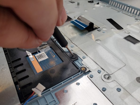

  7. Lenovo Ideapad 320-15IAP Touchpad Replacement, Touchpad: crwdns2935265:07crwdnd2935265:01crwdnd2935265:02crwdne2935265:0 Lenovo Ideapad 320-15IAP Touchpad Replacement, Touchpad: crwdns2935265:07crwdnd2935265:02crwdnd2935265:02crwdne2935265:0
    • Remove the two 2.5mm Phillips #0 screws from the upper edge of the trackpad.
  8. Lenovo Ideapad 320-15IAP Touchpad Replacement: crwdns2935265:08crwdnd2935265:01crwdnd2935265:01crwdne2935265:0
    • Lift the trackpad from its bay from the upper edge to remove it from the laptop.
    • When reinstalling the touchpad, Be sure to insert the bottom edge first.
