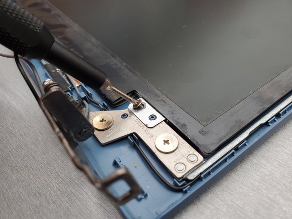

    • Unscrew four 4.5mm screws from the display hinges using a Phillips #0 screwdriver.

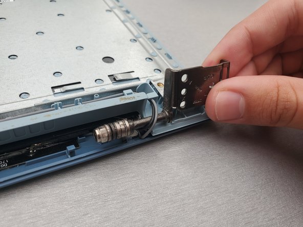

    • Rotate the screen brackets using the opening tool to prop them up.
    • More than likely they will be very hard to pull open. If you have trouble getting them up with an opening tool, you might try opening the laptop while pressing both brackets to the case, then closing the laptop while leaving the brackets up.
    • Remove the display assembly.

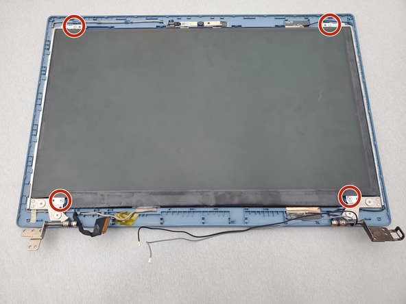

    • Use the opening tool to lift the screen bezel. You may hear popping sounds as the clips disengage.
    • Unscrew four 3mm screws holding the screen onto the laptop case with a Phillips #0 screwdriver.

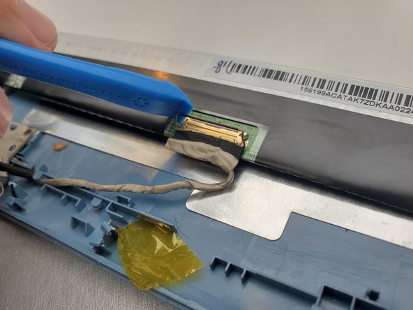

    • Remove the display cable on the backside of the screen by lifting the metal handle up from the connector and gently easing the cable from the connector.
    • Remove the screen from the display case.
