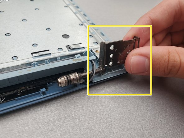

    • Unscrew four 4.5mm screws from the screen brackets using a Phillips #0 screwdriver.
    • Gently pull the wire protector from the back of the computer. You may hear cracking sounds but this is normal, as the locks are disengaging as you pull.

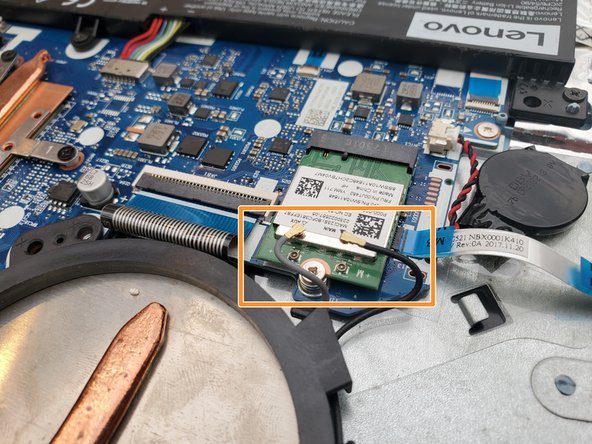

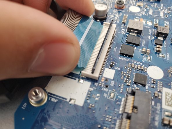

    • Disconnect the display cable by lifting the black tab of the ZIF connector with the opening tool and gently pulling out the cable.
    • Disconnect the two coaxial cables on the WiFi card by gently pulling up on the wires.
    • Lift up the screen brackets by prying upwards on them with an opening tool.
    • It may help to pry up on both brackets simultaneously, but only the righthand one needs to be lifted so that the motherboard can be removed from beneath it.

    • Unscrew four 3mm silver screws on the motherboard using the Phillips #0 screwdriver.
    • Unscrew the single 6mm black screw with a Phillips #0 screwdriver.
    • Unscrewing one of the silver screws will force the WiFi card to pop up. If your new motherboard doesn't come with its own WiFi card, you should unplug the card and install it into your new motherboard.

    • Remove the six ribbon cables by lifting up the locking black tabs from their ZIF connectors with a spudger, then gently pulling out the cables.

I used this for the IdeaPad 330. Worked pretty much the same except in step 2 I broke all the tabs on the wire cover. The cracking sounds definitely were not normal for me on this model.
