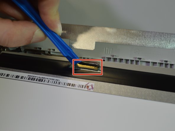

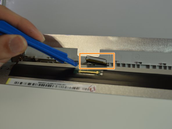

  3. Lenovo Ideapad 320-15ABR Screen Replacement: crwdns2935265:03crwdnd2935265:01crwdnd2935265:03crwdne2935265:0 Lenovo Ideapad 320-15ABR Screen Replacement: crwdns2935265:03crwdnd2935265:02crwdnd2935265:03crwdne2935265:0 Lenovo Ideapad 320-15ABR Screen Replacement: crwdns2935265:03crwdnd2935265:03crwdnd2935265:03crwdne2935265:0
    • Carefully flip the hinge securing the connector up with the opening tool.
    • Slowly work the plug out of the connector.
    • Do not pull by the the cable, as the cable is fragile.
    • Insert the plug from the replacement screen in to the connector. Make sure the connection is secure before flipping the hinge back down.
