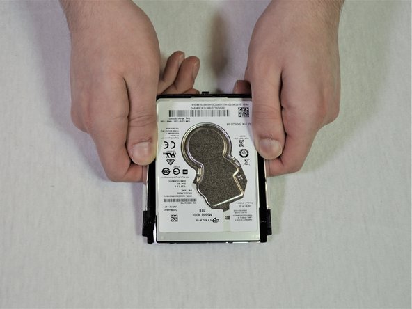

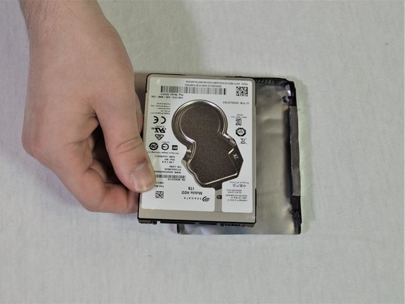

  8. Lenovo Ideapad 320-15ABR Hard Drive Replacement: crwdns2935265:08crwdnd2935265:01crwdnd2935265:03crwdne2935265:0 Lenovo Ideapad 320-15ABR Hard Drive Replacement: crwdns2935265:08crwdnd2935265:02crwdnd2935265:03crwdne2935265:0 Lenovo Ideapad 320-15ABR Hard Drive Replacement: crwdns2935265:08crwdnd2935265:03crwdnd2935265:03crwdne2935265:0
    • Detach the bracket from the hard drive by pulling the bracket edges apart.
