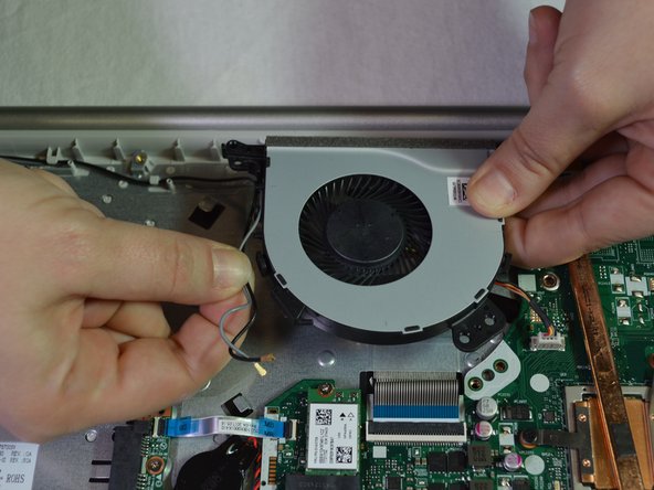

  9. Lenovo Ideapad 320-15ABR Fan Replacement, Fan: crwdns2935265:09crwdnd2935265:01crwdnd2935265:02crwdne2935265:0 Lenovo Ideapad 320-15ABR Fan Replacement, Fan: crwdns2935265:09crwdnd2935265:02crwdnd2935265:02crwdne2935265:0
    • Disconnect black and grey wires by simply giving them a light tug.
  10. Lenovo Ideapad 320-15ABR Fan Replacement: crwdns2935265:010crwdnd2935265:01crwdnd2935265:01crwdne2935265:0
    • Remove the 6mm Phillips #1 screw connecting the fan to the laptop.
  11. Lenovo Ideapad 320-15ABR Fan Replacement: crwdns2935265:011crwdnd2935265:01crwdnd2935265:03crwdne2935265:0 Lenovo Ideapad 320-15ABR Fan Replacement: crwdns2935265:011crwdnd2935265:02crwdnd2935265:03crwdne2935265:0 Lenovo Ideapad 320-15ABR Fan Replacement: crwdns2935265:011crwdnd2935265:03crwdnd2935265:03crwdne2935265:0
    • Lift the fan slightly and straight upward and unwind the black and grey wires from the fan.

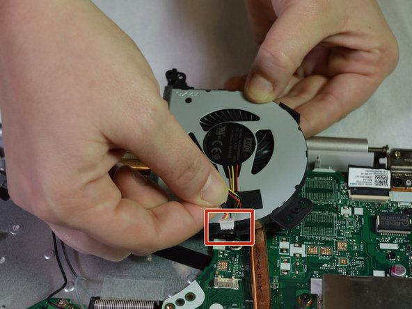

  12. Lenovo Ideapad 320-15ABR Fan Replacement: crwdns2935265:012crwdnd2935265:01crwdnd2935265:01crwdne2935265:0
    • Identify the red, black, yellow, and brown wire coming from the back of the fan connecting to the motherboard with a white connector piece.
  13. Lenovo Ideapad 320-15ABR Fan Replacement: crwdns2935265:013crwdnd2935265:01crwdnd2935265:02crwdne2935265:0 Lenovo Ideapad 320-15ABR Fan Replacement: crwdns2935265:013crwdnd2935265:02crwdnd2935265:02crwdne2935265:0
    • Slowly pull and wiggle the white connector piece until it comes loose from the laptop.
