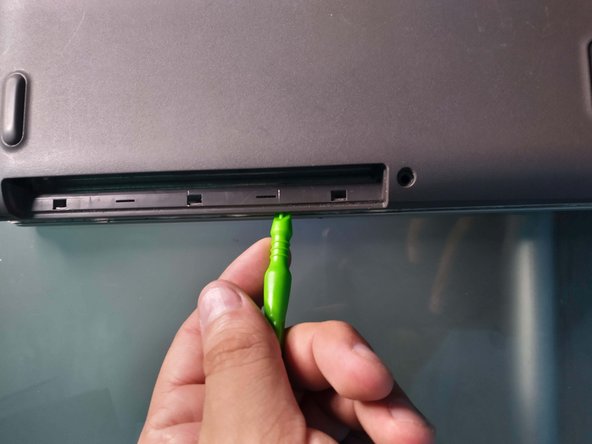

  3. Lenovo Ideapad 320-14ISK RAM Replacement, Opening the laptop: crwdns2935265:03crwdnd2935265:01crwdnd2935265:03crwdne2935265:0 Lenovo Ideapad 320-14ISK RAM Replacement, Opening the laptop: crwdns2935265:03crwdnd2935265:02crwdnd2935265:03crwdne2935265:0 Lenovo Ideapad 320-14ISK RAM Replacement, Opening the laptop: crwdns2935265:03crwdnd2935265:03crwdnd2935265:03crwdne2935265:0
    • Remove the 12 remaining screws. Set them aside orderly.
    • With a plastic spudger, release the tabs that are found below the optical drive.
    • Continues releasing all of the tabs at the edges until the base of the laptop breaks loose.
    • Set the base aside.
