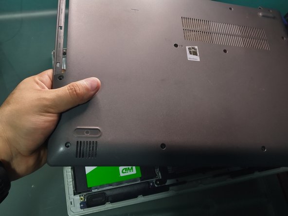

  3. Lenovo Ideapad 320-14ISK Hard Drive Replacement, Opening the laptop: crwdns2935265:03crwdnd2935265:01crwdnd2935265:03crwdne2935265:0 Lenovo Ideapad 320-14ISK Hard Drive Replacement, Opening the laptop: crwdns2935265:03crwdnd2935265:02crwdnd2935265:03crwdne2935265:0 Lenovo Ideapad 320-14ISK Hard Drive Replacement, Opening the laptop: crwdns2935265:03crwdnd2935265:03crwdnd2935265:03crwdne2935265:0
    • Unscrew the remaining 12 screws. Make sure you keep them in order.
    • Using a plastic spudger, loosen the clips located under the disk drive.
    • Keep on doing this down the edge, until the base starts to come loose.
    • Remove the casing and set it aside.

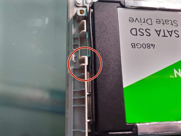

  4. Lenovo Ideapad 320-14ISK Hard Drive Replacement, Remove existing disk drive: crwdns2935265:04crwdnd2935265:01crwdnd2935265:03crwdne2935265:0 Lenovo Ideapad 320-14ISK Hard Drive Replacement, Remove existing disk drive: crwdns2935265:04crwdnd2935265:02crwdnd2935265:03crwdne2935265:0 Lenovo Ideapad 320-14ISK Hard Drive Replacement, Remove existing disk drive: crwdns2935265:04crwdnd2935265:03crwdnd2935265:03crwdne2935265:0
    • Locate the disk drive.
    • Using the spudger, loosen the pin holding the disk drive in place.
    • Remove the existing unit pulling gently and diagonally, as seen in the picture.

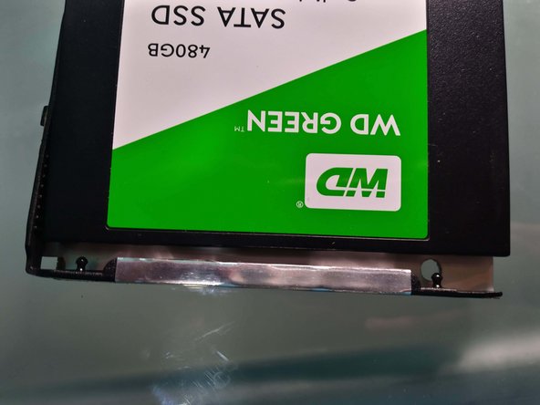

  5. Lenovo Ideapad 320-14ISK Hard Drive Replacement: crwdns2935265:05crwdnd2935265:01crwdnd2935265:03crwdne2935265:0 Lenovo Ideapad 320-14ISK Hard Drive Replacement: crwdns2935265:05crwdnd2935265:02crwdnd2935265:03crwdne2935265:0 Lenovo Ideapad 320-14ISK Hard Drive Replacement: crwdns2935265:05crwdnd2935265:03crwdnd2935265:03crwdne2935265:0
    • Remove the previous disk drive from the flexible protector.
    • Place the new disk, making sure that the port is in the same position as the previous one.
    • Fit the bumpers into the holes that the disk has on both sides.
Now, reassemble the laptop by following steps 1, 2, 3 and 4 in reverse and Congrats! You just installed your new hard drive.
