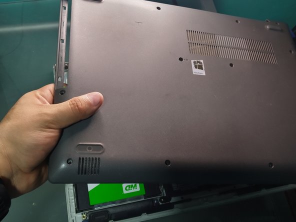

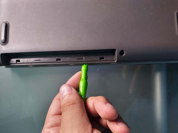

  3. Lenovo Ideapad 320-14ISK Battery Replacement, Opening the laptop: crwdns2935265:03crwdnd2935265:01crwdnd2935265:03crwdne2935265:0 Lenovo Ideapad 320-14ISK Battery Replacement, Opening the laptop: crwdns2935265:03crwdnd2935265:02crwdnd2935265:03crwdne2935265:0 Lenovo Ideapad 320-14ISK Battery Replacement, Opening the laptop: crwdns2935265:03crwdnd2935265:03crwdnd2935265:03crwdne2935265:0
    • Remove the remaining 12 screws. Make sure to keep them organized.
    • Using a plastic spudger, remove the clips from under the disc drive.
    • Continue removing the clips downward until the casing start to loosen.
    • Remove the casing and set it aside.

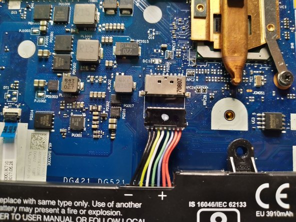

  4. Lenovo Ideapad 320-14ISK Battery Replacement, Removing the battery: crwdns2935265:04crwdnd2935265:01crwdnd2935265:03crwdne2935265:0 Lenovo Ideapad 320-14ISK Battery Replacement, Removing the battery: crwdns2935265:04crwdnd2935265:02crwdnd2935265:03crwdne2935265:0 Lenovo Ideapad 320-14ISK Battery Replacement, Removing the battery: crwdns2935265:04crwdnd2935265:03crwdnd2935265:03crwdne2935265:0
    • Remove the 3 screws that are circled.
    • Lift the battery up and gently pull it to disconnect it.
    • Connect the new battery by pushing the black plastic in until it clicks into place.
Congratulations! You installed your new battery. Now, reassemble the laptop by following the steps in reverse and enjoy your fixed laptop.
