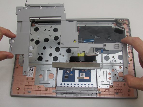

    • Remove six 2.5 mm Phillips #0 screws from the battery bracket.
    • Lift the battery bracket out of the laptop.
  12. Lenovo Ideapad 120s-14IAP Touchpad Replacement: crwdns2935265:012crwdnd2935265:01crwdnd2935265:02crwdne2935265:0 Lenovo Ideapad 120s-14IAP Touchpad Replacement: crwdns2935265:012crwdnd2935265:02crwdnd2935265:02crwdne2935265:0
    • Remove six 5.0 mm Phillips #0 screws from the screen hinges.
    • You can now lift the bottom cover and separate each half of the laptop.

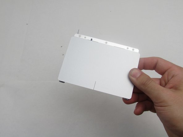

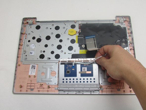

  13. Lenovo Ideapad 120s-14IAP Touchpad Replacement: crwdns2935265:013crwdnd2935265:01crwdnd2935265:03crwdne2935265:0 Lenovo Ideapad 120s-14IAP Touchpad Replacement: crwdns2935265:013crwdnd2935265:02crwdnd2935265:03crwdne2935265:0 Lenovo Ideapad 120s-14IAP Touchpad Replacement: crwdns2935265:013crwdnd2935265:03crwdnd2935265:03crwdne2935265:0
    • The touchpad retention screws are hidden beneath a strip of adhesive. Gently peel the adhesive away to access them.
    • Remove three 2.0 mm Phillips #0 screws from the touchpad retention bracket.
    • The touchpad now slides up and can be removed.
