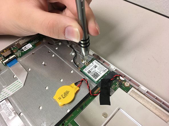

  7. Lenovo Ideapad 110S-11IBR Wi-Fi Card Replacement: crwdns2935265:07crwdnd2935265:01crwdnd2935265:01crwdne2935265:0
    • Disconnect the two wires that are connected to the Wi-Fi card by gently pulling them up.
  8. Lenovo Ideapad 110S-11IBR Wi-Fi Card Replacement: crwdns2935265:08crwdnd2935265:01crwdnd2935265:02crwdne2935265:0 Lenovo Ideapad 110S-11IBR Wi-Fi Card Replacement: crwdns2935265:08crwdnd2935265:02crwdnd2935265:02crwdne2935265:0
    • Unscrew the one 4mm screw keeping the card in place.

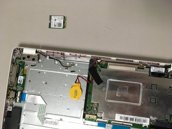

  9. Lenovo Ideapad 110S-11IBR Wi-Fi Card Replacement: crwdns2935265:09crwdnd2935265:01crwdnd2935265:02crwdne2935265:0 Lenovo Ideapad 110S-11IBR Wi-Fi Card Replacement: crwdns2935265:09crwdnd2935265:02crwdnd2935265:02crwdne2935265:0
    • Gently pull the Wi-Fi card out of place.
