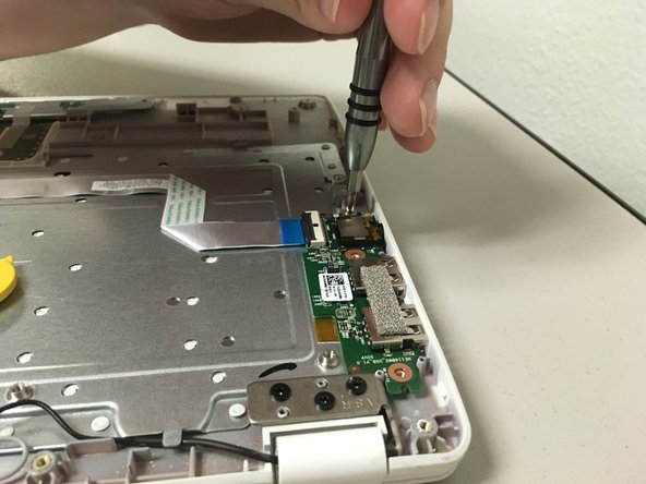

  6. Lenovo Ideapad 110S-11IBR USB & Headphone Jack PCB Board Replacement, USB & Headphone Jack PCB Board: crwdns2935265:06crwdnd2935265:01crwdnd2935265:02crwdne2935265:0 Lenovo Ideapad 110S-11IBR USB & Headphone Jack PCB Board Replacement, USB & Headphone Jack PCB Board: crwdns2935265:06crwdnd2935265:02crwdnd2935265:02crwdne2935265:0
    • Unscrew the three 4 mm Phillips screws.

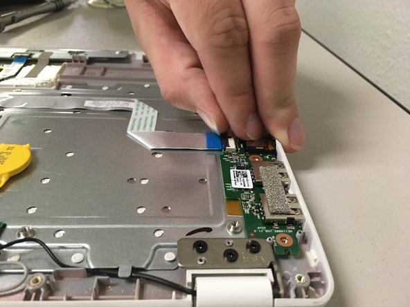

  7. Lenovo Ideapad 110S-11IBR USB & Headphone Jack PCB Board Replacement: crwdns2935265:07crwdnd2935265:01crwdnd2935265:02crwdne2935265:0 Lenovo Ideapad 110S-11IBR USB & Headphone Jack PCB Board Replacement: crwdns2935265:07crwdnd2935265:02crwdnd2935265:02crwdne2935265:0
    • Unlatch and remove the ribbon cable.
    • Ribbon cables can be fragile, so avoid excessively bending it.
  8. Lenovo Ideapad 110S-11IBR USB & Headphone Jack PCB Board Replacement: crwdns2935265:08crwdnd2935265:01crwdnd2935265:01crwdne2935265:0
    • Remove the card from the laptop.
