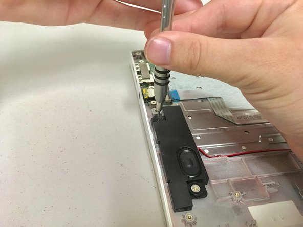

  6. Lenovo Ideapad 110S-11IBR Speaker Replacement, Speaker: crwdns2935265:06crwdnd2935265:01crwdnd2935265:01crwdne2935265:0
    • Use your fingers to gently remove the speaker connector from its socket.
  7. Lenovo Ideapad 110S-11IBR Speaker Replacement: crwdns2935265:07crwdnd2935265:01crwdnd2935265:02crwdne2935265:0 Lenovo Ideapad 110S-11IBR Speaker Replacement: crwdns2935265:07crwdnd2935265:02crwdnd2935265:02crwdne2935265:0
    • Unscrew the four 4mm Phillips screws.
  8. Lenovo Ideapad 110S-11IBR Speaker Replacement: crwdns2935265:08crwdnd2935265:01crwdnd2935265:01crwdne2935265:0
    • Pull the right speaker carefully under the ribbon cable.
  9. Lenovo Ideapad 110S-11IBR Speaker Replacement: crwdns2935265:09crwdnd2935265:01crwdnd2935265:01crwdne2935265:0
    • Lift the the left speaker to finish.
