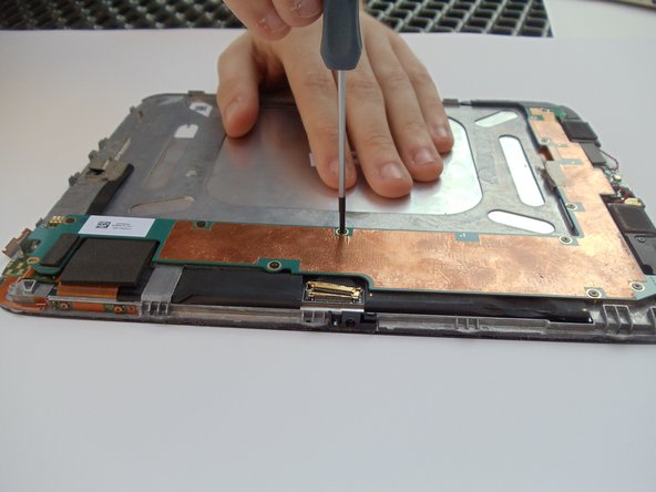

  4. Lenovo IdeaTab S2109A-F System Board Replacement, Unscrewing the System Board: crwdns2935265:04crwdnd2935265:01crwdnd2935265:02crwdne2935265:0 Lenovo IdeaTab S2109A-F System Board Replacement, Unscrewing the System Board: crwdns2935265:04crwdnd2935265:02crwdnd2935265:02crwdne2935265:0
    • Locate the long, L-shaped system board; copper foil runs most of its length.
    • Remove the 10 2mm PH00 black screws located on the edges of the system board using a PH00 Screwdriver.

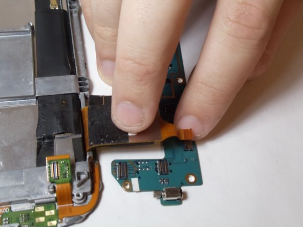

  5. Lenovo IdeaTab S2109A-F System Board Replacement, Disconnecting the First Connection to the System Board: crwdns2935265:05crwdnd2935265:01crwdnd2935265:01crwdne2935265:0
    • First Disconnect the gold connector by lifting the latch on it up and pulling it loose using the latch to pull.

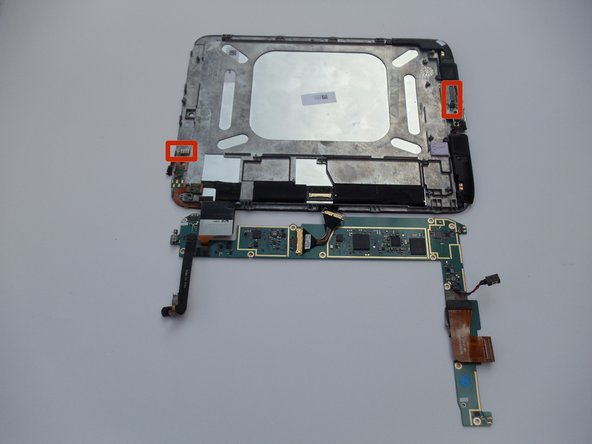

  6. Lenovo IdeaTab S2109A-F System Board Replacement, Disconnecting the next three connections of the System Board: crwdns2935265:06crwdnd2935265:01crwdnd2935265:02crwdne2935265:0 Lenovo IdeaTab S2109A-F System Board Replacement, Disconnecting the next three connections of the System Board: crwdns2935265:06crwdnd2935265:02crwdnd2935265:02crwdne2935265:0
    • As you lift the board up you will notice two more connections, one near the power switch and one on the I/O Panel.
    • Remove each one with a minimal amount of upward pulling force as you flip the board over.

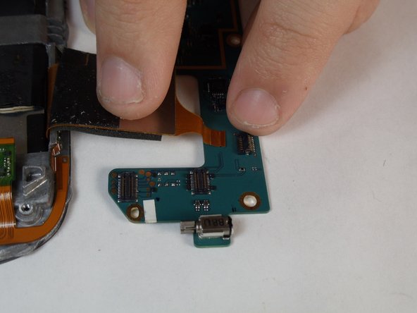

  7. Lenovo IdeaTab S2109A-F System Board Replacement, Disconnecting the final connector of the System Board.: crwdns2935265:07crwdnd2935265:01crwdnd2935265:03crwdne2935265:0 Lenovo IdeaTab S2109A-F System Board Replacement, Disconnecting the final connector of the System Board.: crwdns2935265:07crwdnd2935265:02crwdnd2935265:03crwdne2935265:0 Lenovo IdeaTab S2109A-F System Board Replacement, Disconnecting the final connector of the System Board.: crwdns2935265:07crwdnd2935265:03crwdnd2935265:03crwdne2935265:0
    • To disconnect the system board there is one last connection.
    • Lift up the back latch on this connection and the orange ribbon should slide right out without any effort thus disconnecting the board.
