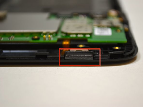

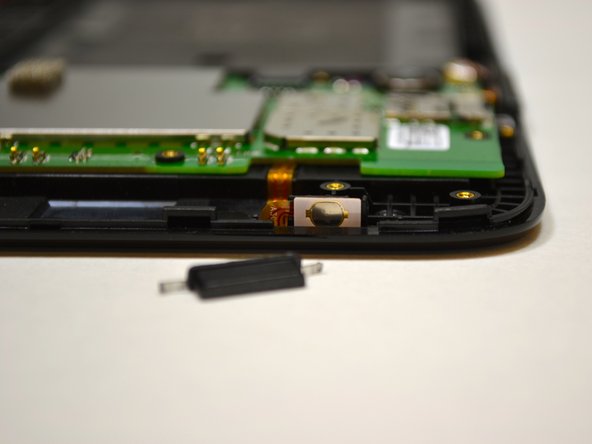

  4. Lenovo IdeaTab A1000L Power and Volume Buttons Replacement: crwdns2935265:04crwdnd2935265:01crwdnd2935265:03crwdne2935265:0 Lenovo IdeaTab A1000L Power and Volume Buttons Replacement: crwdns2935265:04crwdnd2935265:02crwdnd2935265:03crwdne2935265:0 Lenovo IdeaTab A1000L Power and Volume Buttons Replacement: crwdns2935265:04crwdnd2935265:03crwdnd2935265:03crwdne2935265:0
    • Locate the power button on the top right hand corner of your device.
    • Gently slide the button up to remove.
