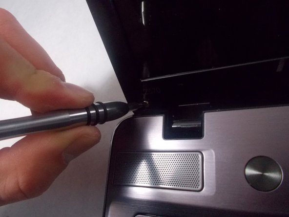

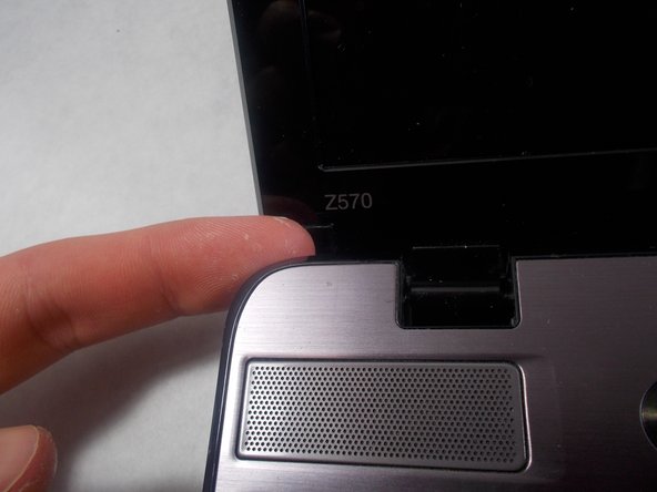

    • Remove the two rubber square screw covers located in the left and right lower hand corners of the screen.
  7. Lenovo IdeaPad Z570 Screen Replacement: crwdns2935265:07crwdnd2935265:01crwdnd2935265:02crwdne2935265:0 Lenovo IdeaPad Z570 Screen Replacement: crwdns2935265:07crwdnd2935265:02crwdnd2935265:02crwdne2935265:0
    • Unscrew the two 4 mm screws behind the two rubber screw covers using the Phillips #0 screwdriver.
  8. Lenovo IdeaPad Z570 Screen Replacement: crwdns2935265:08crwdnd2935265:01crwdnd2935265:02crwdne2935265:0 Lenovo IdeaPad Z570 Screen Replacement: crwdns2935265:08crwdnd2935265:02crwdnd2935265:02crwdne2935265:0

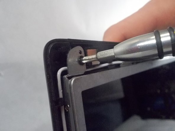

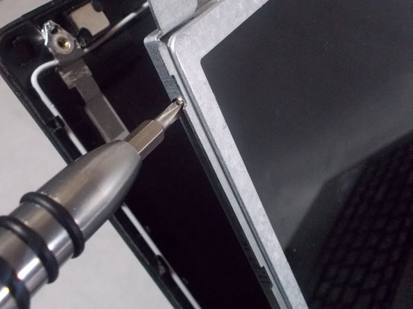

  9. Lenovo IdeaPad Z570 Screen Replacement: crwdns2935265:09crwdnd2935265:01crwdnd2935265:02crwdne2935265:0 Lenovo IdeaPad Z570 Screen Replacement: crwdns2935265:09crwdnd2935265:02crwdnd2935265:02crwdne2935265:0
    • Remove the two 2 mm screws at the top two corners of the screen using the Phillips #0 screwdriver.

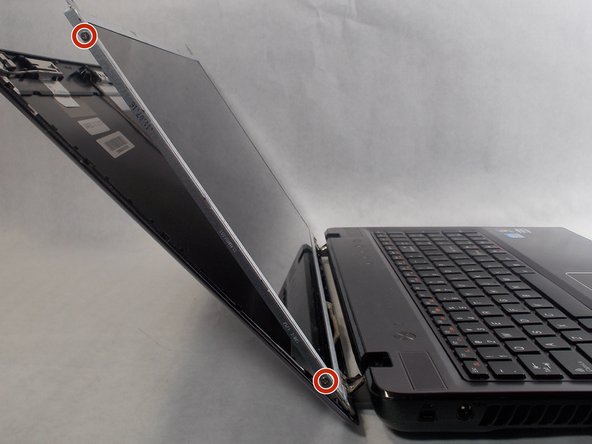

  10. Lenovo IdeaPad Z570 Screen Replacement: crwdns2935265:010crwdnd2935265:01crwdnd2935265:02crwdne2935265:0 Lenovo IdeaPad Z570 Screen Replacement: crwdns2935265:010crwdnd2935265:02crwdnd2935265:02crwdne2935265:0
    • Loosen the four 2 mm screws located at the bottom corners of the screen.
    • These screws cannot be removed.

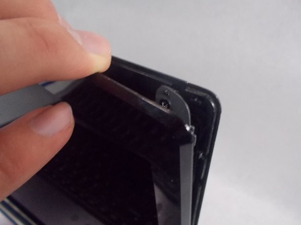

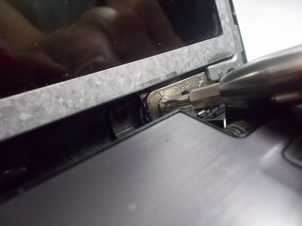

  11. Lenovo IdeaPad Z570 Screen Replacement: crwdns2935265:011crwdnd2935265:01crwdnd2935265:03crwdne2935265:0 Lenovo IdeaPad Z570 Screen Replacement: crwdns2935265:011crwdnd2935265:02crwdnd2935265:03crwdne2935265:0 Lenovo IdeaPad Z570 Screen Replacement: crwdns2935265:011crwdnd2935265:03crwdnd2935265:03crwdne2935265:0
    • Tilt the screen forward gently.
    • Remove four 3 mm screws on the sides of the brackets holding the screen (two on the left side and two on the right side) using the Phillips #0 screwdriver.

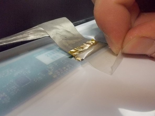

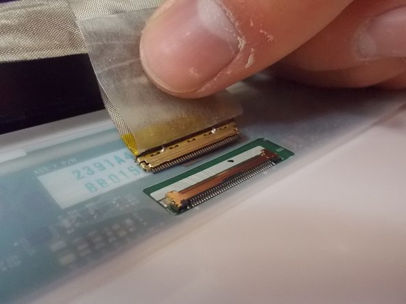

  13. Lenovo IdeaPad Z570 Screen Replacement: crwdns2935265:013crwdnd2935265:01crwdnd2935265:03crwdne2935265:0 Lenovo IdeaPad Z570 Screen Replacement: crwdns2935265:013crwdnd2935265:02crwdnd2935265:03crwdne2935265:0 Lenovo IdeaPad Z570 Screen Replacement: crwdns2935265:013crwdnd2935265:03crwdnd2935265:03crwdne2935265:0
    • Gently remove the adhesive covering surrounding the wires that’s connected to the back of the screen.
    • Disconnect the plug from the connection terminal.
    • Remove the screen completely.
