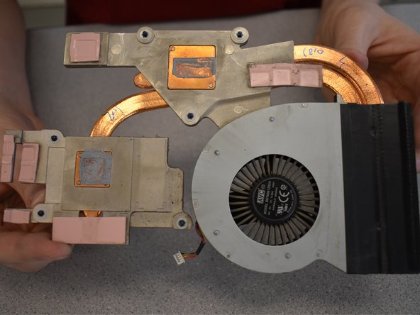

  24. Lenovo IdeaPad Y500 Fan Replacement, Fan: crwdns2935265:024crwdnd2935265:01crwdnd2935265:01crwdne2935265:0
    • With a Phillips #1 screwdriver, loosen the six screws.
    • These screws are spring loaded. They will not come completely out. They only need to be loosened.
  25. Lenovo IdeaPad Y500 Fan Replacement: crwdns2935265:025crwdnd2935265:01crwdnd2935265:03crwdne2935265:0 Lenovo IdeaPad Y500 Fan Replacement: crwdns2935265:025crwdnd2935265:02crwdnd2935265:03crwdne2935265:0 Lenovo IdeaPad Y500 Fan Replacement: crwdns2935265:025crwdnd2935265:03crwdnd2935265:03crwdne2935265:0
    • Gently lift the fan up to remove.
