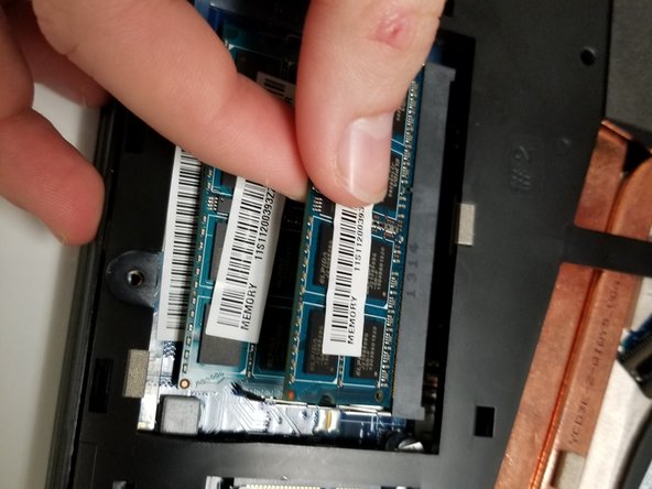

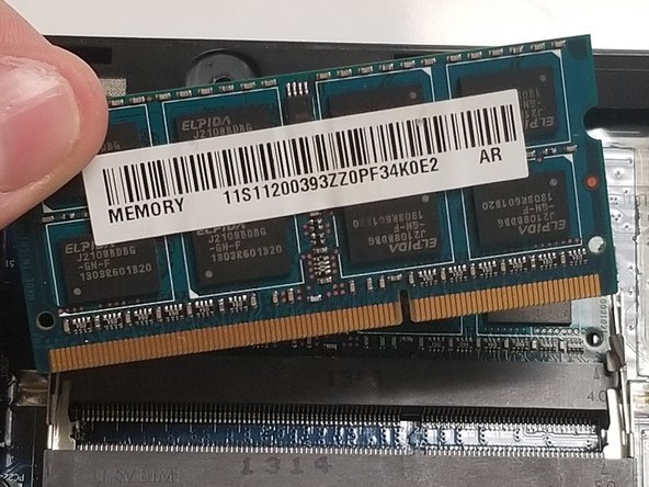

  7. Lenovo IdeaPad Y400 RAM Replacement: crwdns2935265:07crwdnd2935265:01crwdnd2935265:03crwdne2935265:0 Lenovo IdeaPad Y400 RAM Replacement: crwdns2935265:07crwdnd2935265:02crwdnd2935265:03crwdne2935265:0 Lenovo IdeaPad Y400 RAM Replacement: crwdns2935265:07crwdnd2935265:03crwdnd2935265:03crwdne2935265:0
    • Using either the plastic opening tool or your finger, push the metal bits keeping the RAM down off of the RAM.
    • After doing this for both sides, the RAM will pop up, allowing you to take it out.
    • While you take out the RAM, remember not to force it. And take caution while holding the card, as you do not want to touch the golden pins at the bottom.
