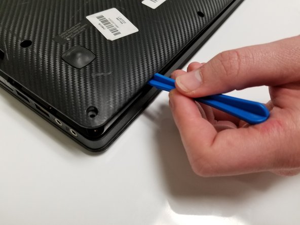

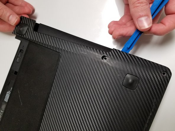

  5. Lenovo IdeaPad Y400 CPU Replacement: crwdns2935265:05crwdnd2935265:01crwdnd2935265:03crwdne2935265:0 Lenovo IdeaPad Y400 CPU Replacement: crwdns2935265:05crwdnd2935265:02crwdnd2935265:03crwdne2935265:0 Lenovo IdeaPad Y400 CPU Replacement: crwdns2935265:05crwdnd2935265:03crwdnd2935265:03crwdne2935265:0
    • Use the plastic opening tool to remove the back panel from the device.
    • Do not force the back off, as you may break the clips keeping it down.

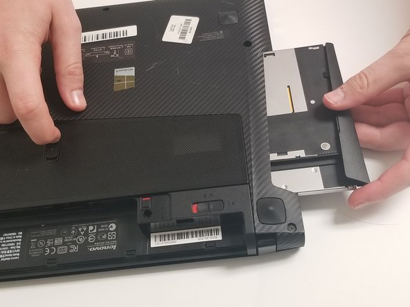

  6. Lenovo IdeaPad Y400 CPU Replacement, Optical Drive: crwdns2935265:06crwdnd2935265:01crwdnd2935265:02crwdne2935265:0 Lenovo IdeaPad Y400 CPU Replacement, Optical Drive: crwdns2935265:06crwdnd2935265:02crwdnd2935265:02crwdne2935265:0
    • Move the lock down until you see red and hear a slight click.
  7. Lenovo IdeaPad Y400 CPU Replacement: crwdns2935265:07crwdnd2935265:01crwdnd2935265:03crwdne2935265:0 Lenovo IdeaPad Y400 CPU Replacement: crwdns2935265:07crwdnd2935265:02crwdnd2935265:03crwdne2935265:0 Lenovo IdeaPad Y400 CPU Replacement: crwdns2935265:07crwdnd2935265:03crwdnd2935265:03crwdne2935265:0
    • Hold this lock down while removing the optical drive.

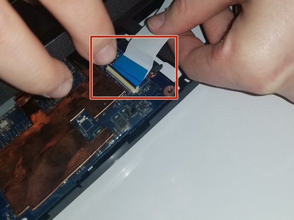

  9. Lenovo IdeaPad Y400 CPU Replacement: crwdns2935265:09crwdnd2935265:01crwdnd2935265:03crwdne2935265:0 Lenovo IdeaPad Y400 CPU Replacement: crwdns2935265:09crwdnd2935265:02crwdnd2935265:03crwdne2935265:0 Lenovo IdeaPad Y400 CPU Replacement: crwdns2935265:09crwdnd2935265:03crwdnd2935265:03crwdne2935265:0
    • Use the plastic opening tool to take off the front panel.
    • Unplug the blue wire to remove the front panel.

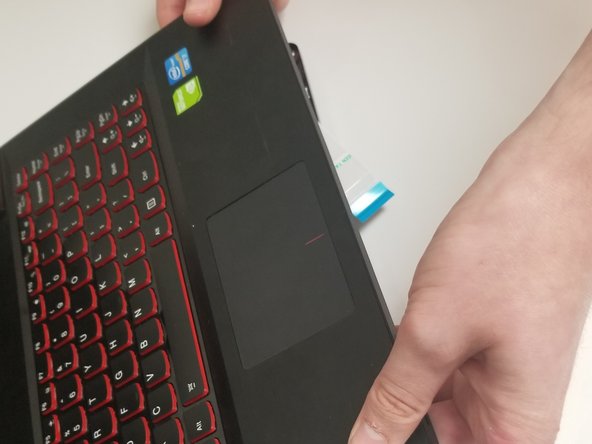

  10. Lenovo IdeaPad Y400 CPU Replacement: crwdns2935265:010crwdnd2935265:01crwdnd2935265:01crwdne2935265:0
    • Fully remove the front panel.
    • Unscrew the 9mm and 4mm screws (there is one of each screw).

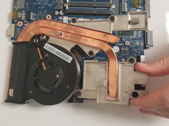

  12. Lenovo IdeaPad Y400 CPU Replacement, CPU: crwdns2935265:012crwdnd2935265:01crwdnd2935265:02crwdne2935265:0 Lenovo IdeaPad Y400 CPU Replacement, CPU: crwdns2935265:012crwdnd2935265:02crwdnd2935265:02crwdne2935265:0
    • Unscrew the six screws using a Phillips #0 screwdriver.
    • These do not come out, do not try and force them out.
    • After you are done unscrewing them, remove the heatsink.
