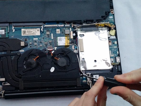

  3. Lenovo IdeaPad Y40-70 Laptop Fan Replacement, Remove the fan: crwdns2935265:03crwdnd2935265:01crwdnd2935265:03crwdne2935265:0 Lenovo IdeaPad Y40-70 Laptop Fan Replacement, Remove the fan: crwdns2935265:03crwdnd2935265:02crwdnd2935265:03crwdne2935265:0 Lenovo IdeaPad Y40-70 Laptop Fan Replacement, Remove the fan: crwdns2935265:03crwdnd2935265:03crwdnd2935265:03crwdne2935265:0
    • Use a small M2.5 Phillips screwdriver to remove the two M2.5 x 4.45 mm screws surrounding the fan.
    • Place these screws to the side, separate from the screws from step one.
    • This screw has a warranty seal covering it. You may void the warranty by disassembling the system further.
    • If you are concerned about the warranty, use compressed air to clean the fan at this step. Afterward, make sure to reassemble the laptop by going through the guide in reverse.

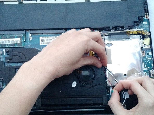

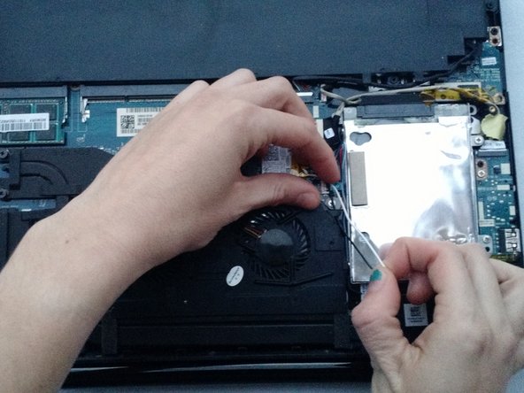

  4. Lenovo IdeaPad Y40-70 Laptop Fan Replacement, Loosen the speaker connectors: crwdns2935265:04crwdnd2935265:01crwdnd2935265:03crwdne2935265:0 Lenovo IdeaPad Y40-70 Laptop Fan Replacement, Loosen the speaker connectors: crwdns2935265:04crwdnd2935265:02crwdnd2935265:03crwdne2935265:0 Lenovo IdeaPad Y40-70 Laptop Fan Replacement, Loosen the speaker connectors: crwdns2935265:04crwdnd2935265:03crwdnd2935265:03crwdne2935265:0
    • Remove the wires from the side of the fan.
    • Carefully unhook each grouping from the small black tabs on the fan.
  5. Lenovo IdeaPad Y40-70 Laptop Fan Replacement, Disconnect the fan: crwdns2935265:05crwdnd2935265:01crwdnd2935265:01crwdne2935265:0
    • Carefully pull out the small white plug connecting the fan to the motherboard.

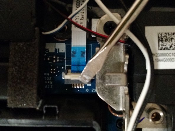

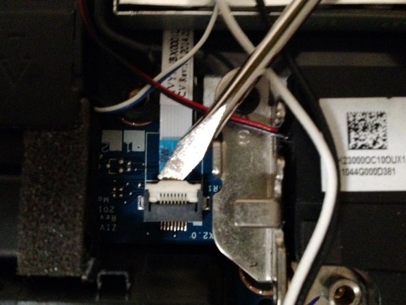

  6. Lenovo IdeaPad Y40-70 Laptop Fan Replacement: crwdns2935265:06crwdnd2935265:01crwdnd2935265:03crwdne2935265:0 Lenovo IdeaPad Y40-70 Laptop Fan Replacement: crwdns2935265:06crwdnd2935265:02crwdnd2935265:03crwdne2935265:0 Lenovo IdeaPad Y40-70 Laptop Fan Replacement: crwdns2935265:06crwdnd2935265:03crwdnd2935265:03crwdne2935265:0
    • Use a small flathead screwdriver to pull upwards on the tab connecting the white ribbon wire to the board. Unhook the white wire from the black latch.

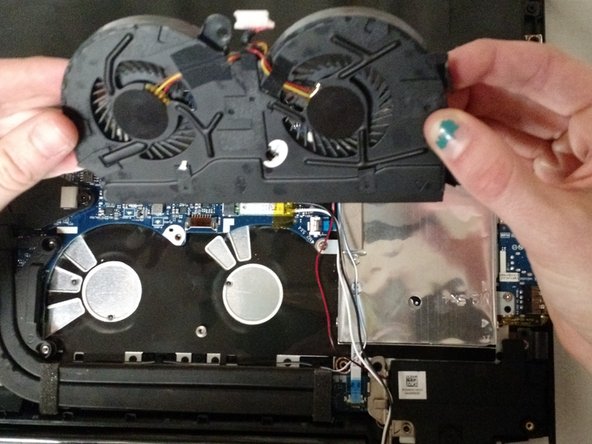

  7. Lenovo IdeaPad Y40-70 Laptop Fan Replacement, Remove the fan: crwdns2935265:07crwdnd2935265:01crwdnd2935265:03crwdne2935265:0 Lenovo IdeaPad Y40-70 Laptop Fan Replacement, Remove the fan: crwdns2935265:07crwdnd2935265:02crwdnd2935265:03crwdne2935265:0 Lenovo IdeaPad Y40-70 Laptop Fan Replacement, Remove the fan: crwdns2935265:07crwdnd2935265:03crwdnd2935265:03crwdne2935265:0
    • Carefully lift the fan out of the computer and place it on a clean surface.
    • As you lift up the left side, you will have to apply some force to overcome the adhesive on the bottom.

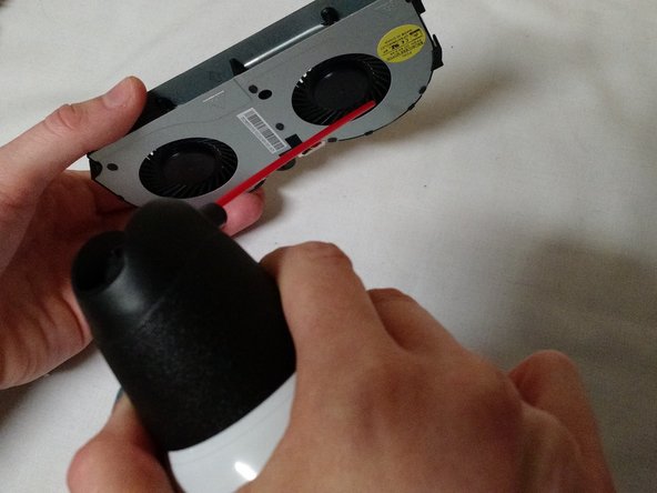

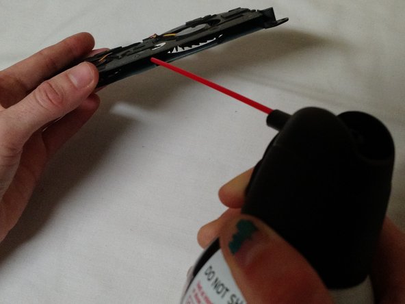

  8. Lenovo IdeaPad Y40-70 Laptop Fan Replacement, Clean the fan: crwdns2935265:08crwdnd2935265:01crwdnd2935265:03crwdne2935265:0 Lenovo IdeaPad Y40-70 Laptop Fan Replacement, Clean the fan: crwdns2935265:08crwdnd2935265:02crwdnd2935265:03crwdne2935265:0 Lenovo IdeaPad Y40-70 Laptop Fan Replacement, Clean the fan: crwdns2935265:08crwdnd2935265:03crwdnd2935265:03crwdne2935265:0
    • Use compressed air or a vacuum with a tube to clean out the dust from the fan.
    • If you wish to replace the fan, set the old fan to the side, and complete the reassembly using your replacement.
