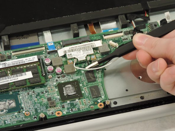

    • Remove the black and white wires that attach the fan to the network adapter.

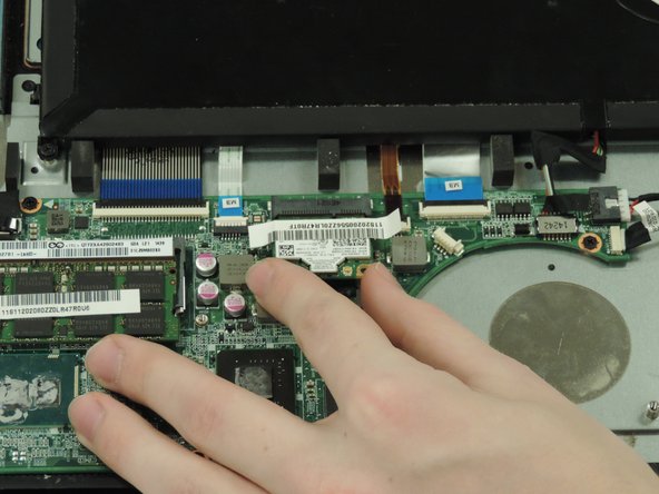

  4. Lenovo IdeaPad U530 Touch Network Adapter Replacement: crwdns2935265:04crwdnd2935265:01crwdnd2935265:02crwdne2935265:0 Lenovo IdeaPad U530 Touch Network Adapter Replacement: crwdns2935265:04crwdnd2935265:02crwdnd2935265:02crwdne2935265:0
    • Remove the two screws attaching the network adapter to the motherboard.
    • Remove the network adapter by sliding it down out of its connector.
