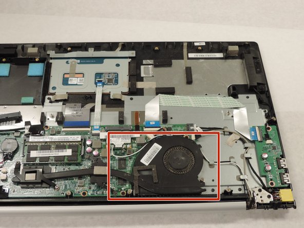

    • Locate the fan and associated parts. It will be in the bottom right of the computer pictured. It is black and has an extension heading off toward the left.

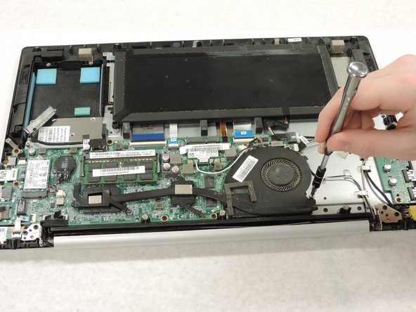

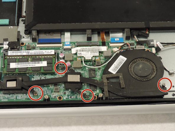

    • Unscrew the fan casing by using a PH1 size screwdriver head.
    • All fan screws are attached to the fan apparatus, so do not attempt to separate them after unscrewing them.

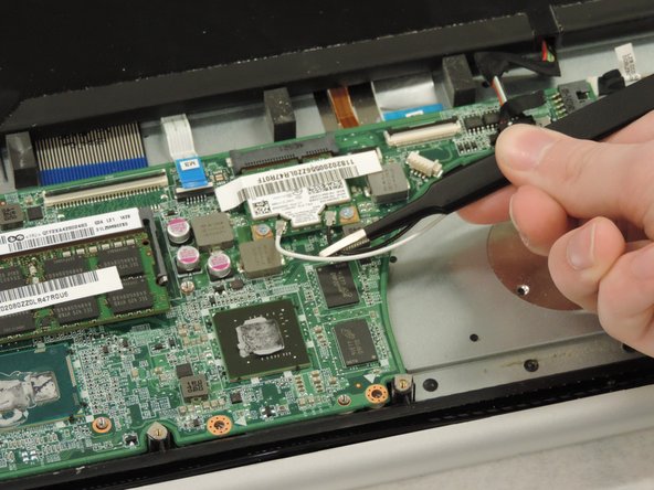

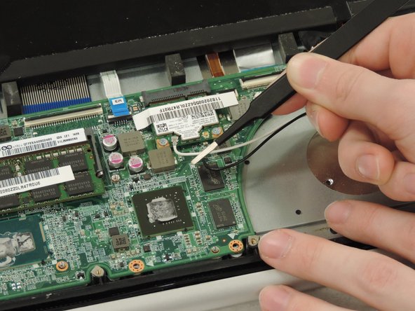

    • Remove the black and white wires connecting the fan to the network adapter.

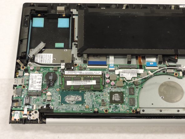

    • Lift the fan straight out of the casing.
