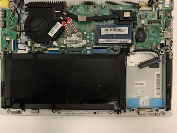

  3. Lenovo IdeaPad U430 Touch Wifi Card Replacement, Wifi Card: crwdns2935265:04crwdnd2935265:01crwdnd2935265:01crwdne2935265:0
    • Remove the two 2.8mm screws using the Phillips #0 screwdriver.
  4. Lenovo IdeaPad U430 Touch Wifi Card Replacement: crwdns2935265:05crwdnd2935265:01crwdnd2935265:02crwdne2935265:0 Lenovo IdeaPad U430 Touch Wifi Card Replacement: crwdns2935265:05crwdnd2935265:02crwdnd2935265:02crwdne2935265:0
    • Remove the two snap cables connecting the wifi card to the rest of the computer.
  5. Lenovo IdeaPad U430 Touch Wifi Card Replacement: crwdns2935265:06crwdnd2935265:01crwdnd2935265:01crwdne2935265:0
    • Slide the Wifi card away from the Wifi card connector.
