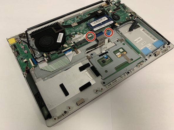

  6. Lenovo IdeaPad U430 Touch Trackpad Replacement, Trackpad: crwdns2935265:07crwdnd2935265:01crwdnd2935265:02crwdne2935265:0 Lenovo IdeaPad U430 Touch Trackpad Replacement, Trackpad: crwdns2935265:07crwdnd2935265:02crwdnd2935265:02crwdne2935265:0
    • Remove the two 2.8 mm screws attached to the trackpad using the Phillips #1 screwdriver.
    • Detach the zif ribbon labeled "TP" and "MB" at the "MB" end.
  7. Lenovo IdeaPad U430 Touch Trackpad Replacement: crwdns2935265:08crwdnd2935265:01crwdnd2935265:01crwdne2935265:0
    • Grasping one of the screw brackets, gently lift the trackpad out of its frame.
