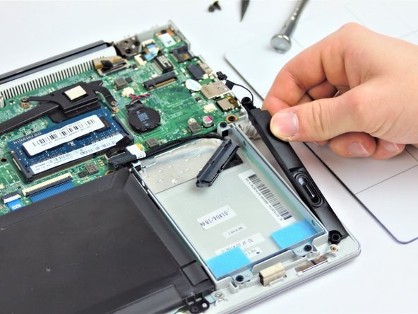

  3. Lenovo IdeaPad U430 Touch Speaker Replacement, Speaker: crwdns2935265:04crwdnd2935265:01crwdnd2935265:01crwdne2935265:0
    • Disconnect the speaker cable connectors from the motherboard and/or USB board.

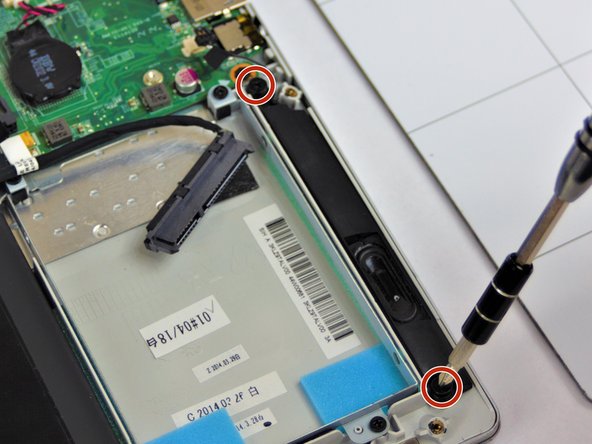

  4. Lenovo IdeaPad U430 Touch Speaker Replacement: crwdns2935265:05crwdnd2935265:01crwdnd2935265:02crwdne2935265:0 Lenovo IdeaPad U430 Touch Speaker Replacement: crwdns2935265:05crwdnd2935265:02crwdnd2935265:02crwdne2935265:0
    • Unscrew the two 6.5mm screws from each speaker with a PH1 Phillips head screwdriver.
  5. Lenovo IdeaPad U430 Touch Speaker Replacement: crwdns2935265:06crwdnd2935265:01crwdnd2935265:02crwdne2935265:0 Lenovo IdeaPad U430 Touch Speaker Replacement: crwdns2935265:06crwdnd2935265:02crwdnd2935265:02crwdne2935265:0
    • Remove and replace the speaker.
