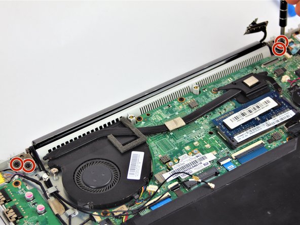

  3. Lenovo IdeaPad U430 Touch Screen Replacement, Touch Screen: crwdns2935265:04crwdnd2935265:01crwdnd2935265:02crwdne2935265:0 Lenovo IdeaPad U430 Touch Screen Replacement, Touch Screen: crwdns2935265:04crwdnd2935265:02crwdnd2935265:02crwdne2935265:0
    • Remove the four 4.5mm screws from the screen hinges.

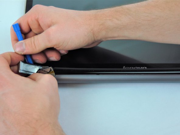

    • Using the spudger and the plastic opening tool, carefully remove the plastic cover from the bottom of the screen.
    • Plastic clips can be fragile, so take your time to carefully remove.
  9. Lenovo IdeaPad U430 Touch Screen Replacement: crwdns2935265:010crwdnd2935265:01crwdnd2935265:01crwdne2935265:0
    • Using the PH1 Phillips head, remove the 3mm screws from the left side screen hinge on the screen assembly.
    • Remove the hinge.
    • Using the PH000 Phillips head screwdriver, remove the three 2mm screws that are securing the bottom of the screen.
    • Using the plastic opening tool and the plastic spudger, work your way around the screen to release it from the case.
    • Remove the screen.
