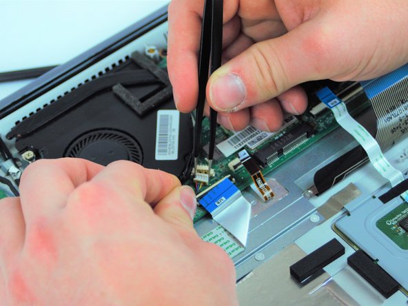

  7. Lenovo IdeaPad U430 Touch Motherboard Replacement: crwdns2935265:08crwdnd2935265:01crwdnd2935265:03crwdne2935265:0 Lenovo IdeaPad U430 Touch Motherboard Replacement: crwdns2935265:08crwdnd2935265:02crwdnd2935265:03crwdne2935265:0 Lenovo IdeaPad U430 Touch Motherboard Replacement: crwdns2935265:08crwdnd2935265:03crwdnd2935265:03crwdne2935265:0
    • Using a plastic spudger, liift up and remove the hard drive and screen flat-topped connectors
    • Use the spudger and metal tweezers to remove the two cable connectors and two bundled cable connectors.
    • Use the plastic spudger to lift up and remove the two antenna connectors.
