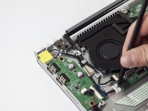

    • Disconnect charging port from motherboard.
    • To do this, press the spudger on the center dimple and push the connector out.

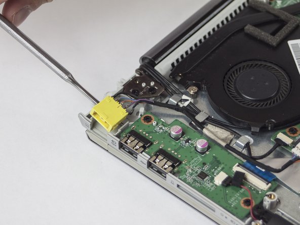

  4. Lenovo IdeaPad U430 Touch Charging Port Replacement: crwdns2935265:05crwdnd2935265:01crwdnd2935265:02crwdne2935265:0 Lenovo IdeaPad U430 Touch Charging Port Replacement: crwdns2935265:05crwdnd2935265:02crwdnd2935265:02crwdne2935265:0
    • Pry the charging port out of the socket with a metal spudger.
    • It may be necessary to pry from each side.
  5. Lenovo IdeaPad U430 Touch Charging Port Replacement: crwdns2935265:06crwdnd2935265:01crwdnd2935265:01crwdne2935265:0
    • Remove charging port from laptop.
