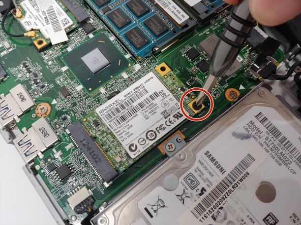

  3. Lenovo IdeaPad U410 Solid State Drive  Replacement, Solid State Drive: crwdns2935265:03crwdnd2935265:01crwdnd2935265:03crwdne2935265:0 Lenovo IdeaPad U410 Solid State Drive  Replacement, Solid State Drive: crwdns2935265:03crwdnd2935265:02crwdnd2935265:03crwdne2935265:0 Lenovo IdeaPad U410 Solid State Drive  Replacement, Solid State Drive: crwdns2935265:03crwdnd2935265:03crwdnd2935265:03crwdne2935265:0
    • Make sure your laptop is powered off.
    • Use a Phillips #1 screwdriver to remove the 3 mm screw holding the SSD in place.

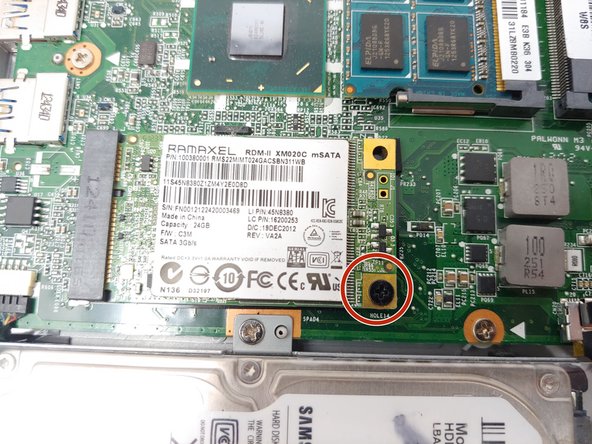

  4. Lenovo IdeaPad U410 Solid State Drive  Replacement: crwdns2935265:04crwdnd2935265:01crwdnd2935265:01crwdne2935265:0
    • Grab the SSD and pull it out from the mSATA slot.
