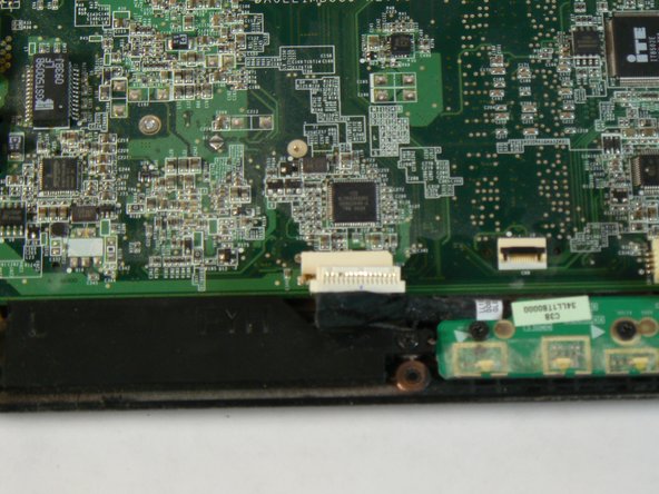

  18. Lenovo IdeaPad U350 Thermal Paste Replacement: crwdns2935265:018crwdnd2935265:01crwdnd2935265:01crwdne2935265:0
    • Unplug the speaker wire from the motherboard.
  19. Lenovo IdeaPad U350 Thermal Paste Replacement: crwdns2935265:019crwdnd2935265:01crwdnd2935265:02crwdne2935265:0 Lenovo IdeaPad U350 Thermal Paste Replacement: crwdns2935265:019crwdnd2935265:02crwdnd2935265:02crwdne2935265:0

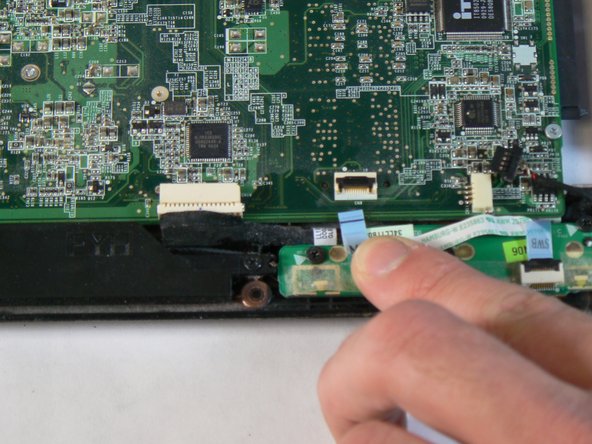

    • Use the blue opening tool or spudger to unlatch the indicator LED board ZIF connector.
    • Pull the indicator LED board ribbon cable out of the connector.
  20. Lenovo IdeaPad U350 Thermal Paste Replacement: crwdns2935265:020crwdnd2935265:01crwdnd2935265:02crwdne2935265:0 Lenovo IdeaPad U350 Thermal Paste Replacement: crwdns2935265:020crwdnd2935265:02crwdnd2935265:02crwdne2935265:0
    • Unplug the I/O daughterboard cable from the motherboard.

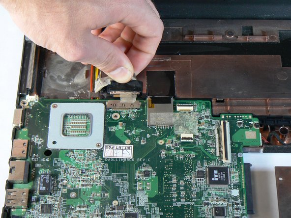

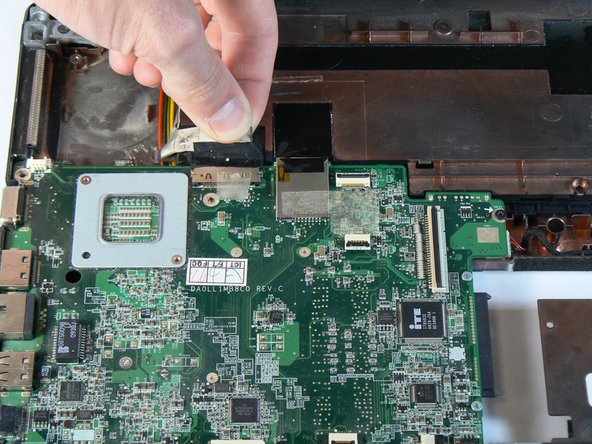

  21. Lenovo IdeaPad U350 Thermal Paste Replacement: crwdns2935265:021crwdnd2935265:01crwdnd2935265:01crwdne2935265:0
    • Unscrew the four remaining screws that are holding the motherboard in place using a PH1 bit. The silver screws are 5.6mm long and the black screws are 3.6mm long.
  22. Lenovo IdeaPad U350 Thermal Paste Replacement: crwdns2935265:022crwdnd2935265:01crwdnd2935265:02crwdne2935265:0 Lenovo IdeaPad U350 Thermal Paste Replacement: crwdns2935265:022crwdnd2935265:02crwdnd2935265:02crwdne2935265:0

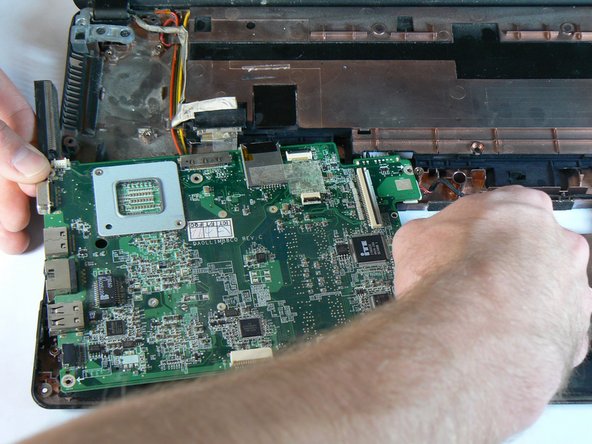

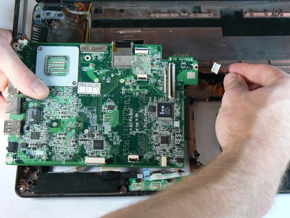

    • Begin lifting the motherboard out from the top left and bottom right corners.
    • The battery terminal on the top right corner of the motherboard will likely be lodged in the hole leading to the battery compartment. Some wiggling may be necessary in order to free it.
  23. Lenovo IdeaPad U350 Thermal Paste Replacement: crwdns2935265:023crwdnd2935265:01crwdnd2935265:02crwdne2935265:0 Lenovo IdeaPad U350 Thermal Paste Replacement: crwdns2935265:023crwdnd2935265:02crwdnd2935265:02crwdne2935265:0
    • Unplug the power port cable from the motherboard.
  24. Lenovo IdeaPad U350 Thermal Paste Replacement: crwdns2935265:024crwdnd2935265:01crwdnd2935265:01crwdne2935265:0
    • Disconnect the remaining cable on the bottom right corner of the motherboard.

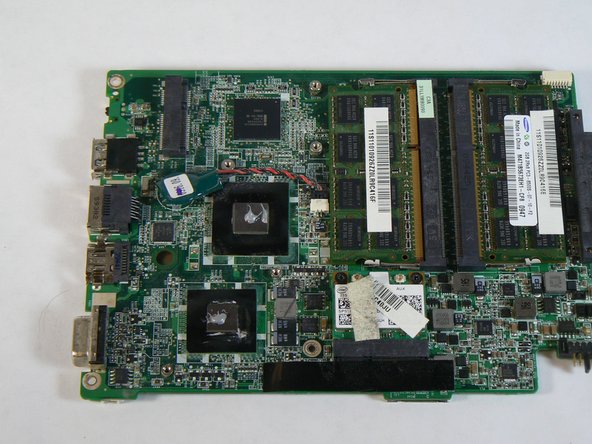

    • Unscrew the three heatsink screws using a PH1 bit. These screws are attached to heatsink assembly.
  26. Lenovo IdeaPad U350 Thermal Paste Replacement: crwdns2935265:026crwdnd2935265:01crwdnd2935265:01crwdne2935265:0
    • Clean off the old thermal paste from the bottom of the heatsink. Using rubbing alcohol can make the process easier.
  27. Lenovo IdeaPad U350 Thermal Paste Replacement: crwdns2935265:027crwdnd2935265:01crwdnd2935265:01crwdne2935265:0
    • Clean the old thermal paste off of the CPU and Northbridge dies on the motherboard.
    • Never use any object harder than soft plastic for scraping off tough thermal paste. Doing so can scratch the dies or traces, leaving the processor inoperable.
