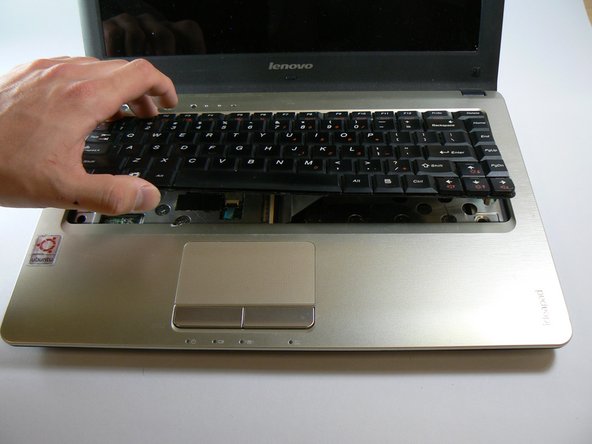

  5. Lenovo IdeaPad U350 Keyboard Replacement: crwdns2935265:05crwdnd2935265:01crwdnd2935265:01crwdne2935265:0
    • Slightly lift the bottom of the keyboard towards the screen to locate the keyboard's ribbon cable.
    • Use the tip of the spudger to lift the black retaining flap on the ZIF connector.
    • You should now be able to lift out the keyboard easily.
