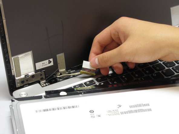

  13. Lenovo IdeaPad U310 Screen  Replacement: crwdns2935265:013crwdnd2935265:01crwdnd2935265:02crwdne2935265:0 Lenovo IdeaPad U310 Screen  Replacement: crwdns2935265:013crwdnd2935265:02crwdnd2935265:02crwdne2935265:0
    • Peel back the white tape, revealing the power connection.
  14. Lenovo IdeaPad U310 Screen  Replacement: crwdns2935265:014crwdnd2935265:01crwdnd2935265:02crwdne2935265:0 Lenovo IdeaPad U310 Screen  Replacement: crwdns2935265:014crwdnd2935265:02crwdnd2935265:02crwdne2935265:0
    • Unplug the connector, pulling it by the white tape.
