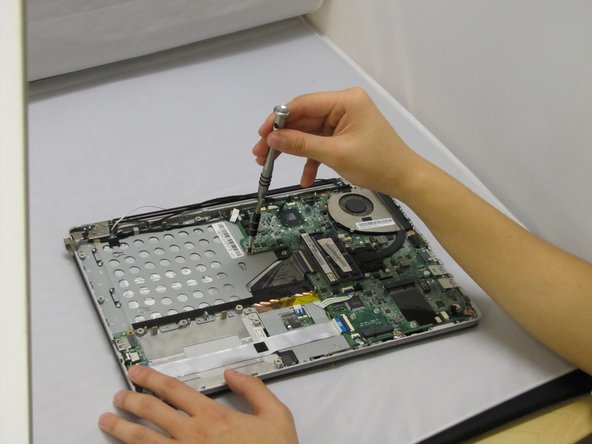

    • Remove the two 4.6 mm screws using PH1.
    • One is located next to the fan, the other at the corner of the battery.

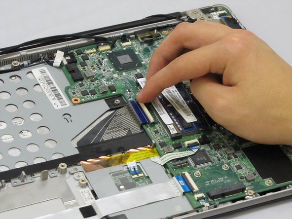

    • Pry up the hinge that houses the keyboard's ribbon cable.
  10. Lenovo IdeaPad U310 Keyboard  Replacement: crwdns2935265:010crwdnd2935265:01crwdnd2935265:01crwdne2935265:0
    • Remove the ribbon from its housing.
