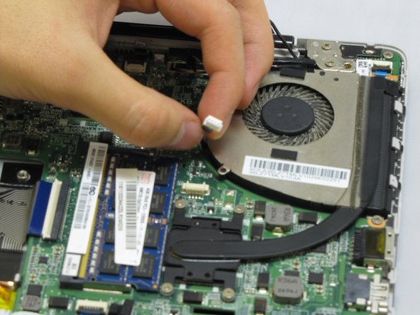

  8. Lenovo IdeaPad U310 Fan Replacement, Fan: crwdns2935265:08crwdnd2935265:01crwdnd2935265:02crwdne2935265:0 Lenovo IdeaPad U310 Fan Replacement, Fan: crwdns2935265:08crwdnd2935265:02crwdnd2935265:02crwdne2935265:0
    • Unplug fan by pinching the connector and pulling it away from its housing.
