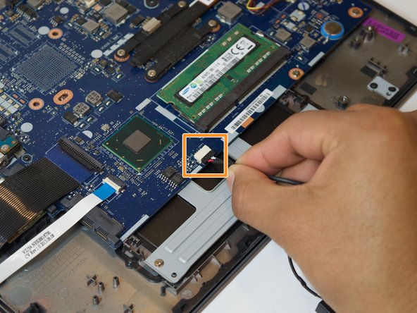

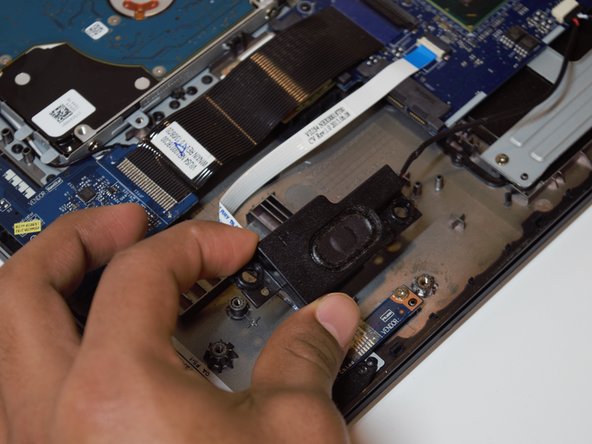

    • Remove the two 2mm Phillips #0 screws from each speaker.
    • Take the speakers off the base.
    • Pull the connecting cable from the motherboard, which will release the speakers.
    • To install the replacement speakers, follow these steps in reverse order.
