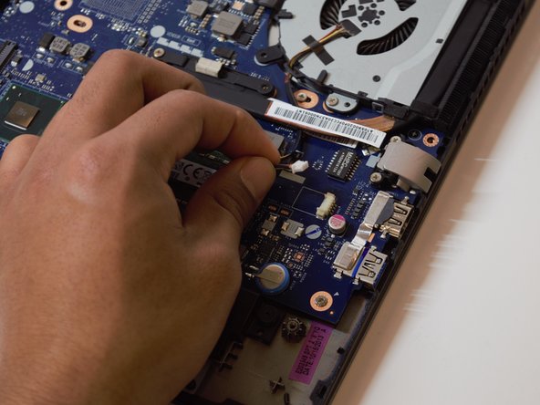

  4. Lenovo IdeaPad S400 Touch Fan Replacement: crwdns2935265:04crwdnd2935265:01crwdnd2935265:01crwdne2935265:0
    • Remove the two 5mm Phillips #0 screws holding the fan down.
  5. Lenovo IdeaPad S400 Touch Fan Replacement: crwdns2935265:05crwdnd2935265:01crwdnd2935265:02crwdne2935265:0 Lenovo IdeaPad S400 Touch Fan Replacement: crwdns2935265:05crwdnd2935265:02crwdnd2935265:02crwdne2935265:0
    • Unplug the fan's power supply cord.
  6. Lenovo IdeaPad S400 Touch Fan Replacement: crwdns2935265:06crwdnd2935265:01crwdnd2935265:01crwdne2935265:0
    • Pull the fan out.
