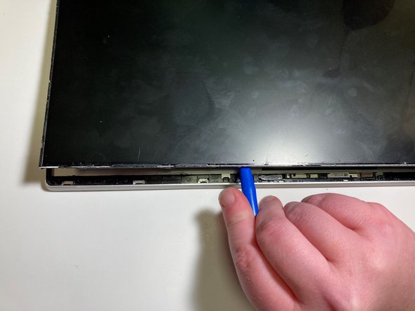

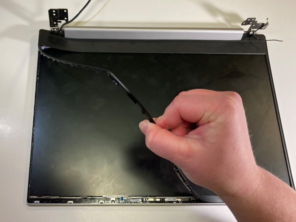

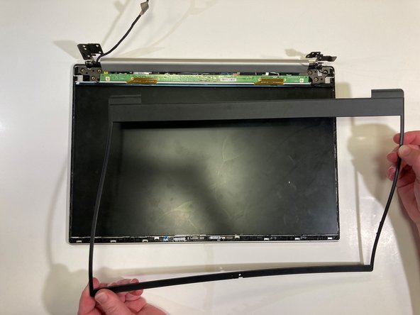

  23. Lenovo IdeaPad S340-15IWL Screen Replacement, Screen: crwdns2935265:023crwdnd2935265:01crwdnd2935265:03crwdne2935265:0 Lenovo IdeaPad S340-15IWL Screen Replacement, Screen: crwdns2935265:023crwdnd2935265:02crwdnd2935265:03crwdne2935265:0 Lenovo IdeaPad S340-15IWL Screen Replacement, Screen: crwdns2935265:023crwdnd2935265:03crwdnd2935265:03crwdne2935265:0
    • Using an opening tool, carefully pry up and remove the plastic bezel casing surrounding the screen.
  24. Lenovo IdeaPad S340-15IWL Screen Replacement: crwdns2935265:024crwdnd2935265:01crwdnd2935265:02crwdne2935265:0 Lenovo IdeaPad S340-15IWL Screen Replacement: crwdns2935265:024crwdnd2935265:02crwdnd2935265:02crwdne2935265:0
    • Using a plastic opening tool, very carefully begin to remove its casing.
    • Be EXTREMELY careful when removing your screen. Make sure that your prying tool is wedged completely under the screen and the foundation holding it in place; it’s easy to accidentally insert the tool into the LCD itself and crack the screen.
    • The screen is held to the casing with a few strips of extremely strong foam adhesive. If possible, it is best to use the prying tool to separate the adhesive from the screen before attempting to remove it.

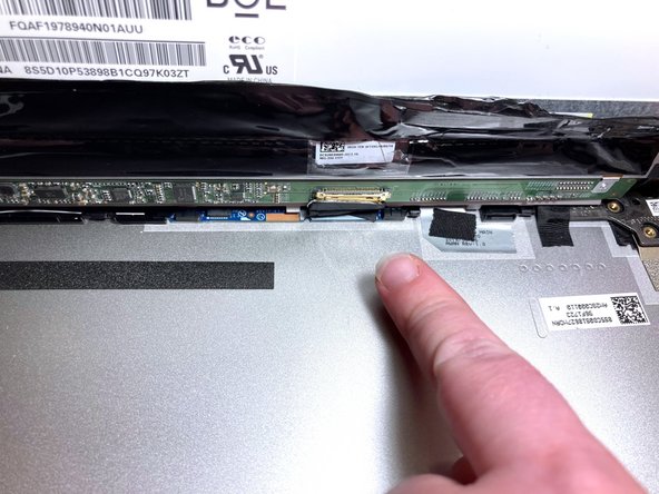

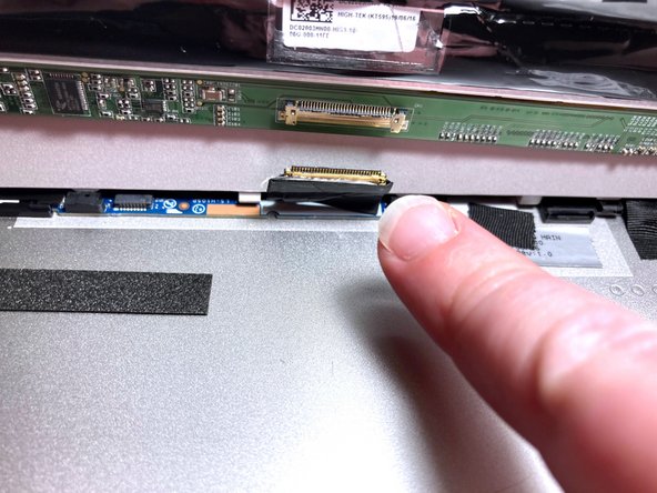

  25. Lenovo IdeaPad S340-15IWL Screen Replacement: crwdns2935265:025crwdnd2935265:01crwdnd2935265:03crwdne2935265:0 Lenovo IdeaPad S340-15IWL Screen Replacement: crwdns2935265:025crwdnd2935265:02crwdnd2935265:03crwdne2935265:0 Lenovo IdeaPad S340-15IWL Screen Replacement: crwdns2935265:025crwdnd2935265:03crwdnd2935265:03crwdne2935265:0
    • Lift the display up very carefully.
    • Beneath the electrical tape protecting the circuit board is a small black and gold cable.
    • Gently unplug this cable, and then remove the screen from the casing.
