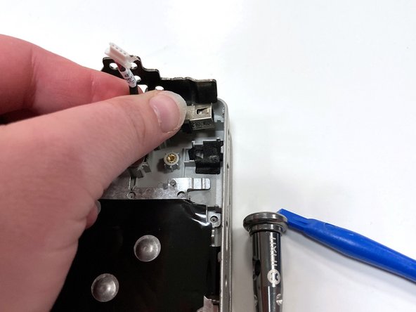

  23. Lenovo IdeaPad S340-15IWL Keyboard Replacement, Charging Port: crwdns2935265:023crwdnd2935265:01crwdnd2935265:02crwdne2935265:0 Lenovo IdeaPad S340-15IWL Keyboard Replacement, Charging Port: crwdns2935265:023crwdnd2935265:02crwdnd2935265:02crwdne2935265:0
    • Disconnect the battery cable by gently pulling it straight out of the connector.
    • Be sure to pull parallel to the device to avoid bending the motherboard connector.
    • The battery connector does not lock and only requires light pressure to insert and remove.
  24. Lenovo IdeaPad S340-15IWL Keyboard Replacement: crwdns2935265:024crwdnd2935265:01crwdnd2935265:01crwdne2935265:0
    • Remove the three total silver 6 mm screws from the hinge of the screen in the top right corner of the device using a Phillips #0 screwdriver.
  25. Lenovo IdeaPad S340-15IWL Keyboard Replacement: crwdns2935265:025crwdnd2935265:01crwdnd2935265:02crwdne2935265:0 Lenovo IdeaPad S340-15IWL Keyboard Replacement: crwdns2935265:025crwdnd2935265:02crwdnd2935265:02crwdne2935265:0
    • Use an opening tool to flip up the hinges.
    • You may have to apply some force.
  26. Lenovo IdeaPad S340-15IWL Keyboard Replacement: crwdns2935265:026crwdnd2935265:01crwdnd2935265:02crwdne2935265:0 Lenovo IdeaPad S340-15IWL Keyboard Replacement: crwdns2935265:026crwdnd2935265:02crwdnd2935265:02crwdne2935265:0
    • Unplug the charging port cable by sliding it out of its motherboard socket.
  27. Lenovo IdeaPad S340-15IWL Keyboard Replacement: crwdns2935265:027crwdnd2935265:01crwdnd2935265:02crwdne2935265:0 Lenovo IdeaPad S340-15IWL Keyboard Replacement: crwdns2935265:027crwdnd2935265:02crwdnd2935265:02crwdne2935265:0
    • Remove the charging port by pulling vertically at the base of the wires.

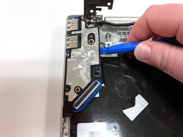

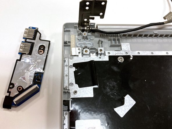

  30. Lenovo IdeaPad S340-15IWL Keyboard Replacement, USB Port Board: crwdns2935265:030crwdnd2935265:01crwdnd2935265:03crwdne2935265:0 Lenovo IdeaPad S340-15IWL Keyboard Replacement, USB Port Board: crwdns2935265:030crwdnd2935265:02crwdnd2935265:03crwdne2935265:0 Lenovo IdeaPad S340-15IWL Keyboard Replacement, USB Port Board: crwdns2935265:030crwdnd2935265:03crwdnd2935265:03crwdne2935265:0
    • Remove the silver 6 mm screw holding the USB and SD card slots in place in the upper left corner of the device using a Phillips #0 screwdriver.
    • Remove the black 3 mm screw holding the USB and SD card slots in place in the upper left corner of the device using a Phillips #0 screwdriver.
    • Use an opening tool to pry the port out of the device.
