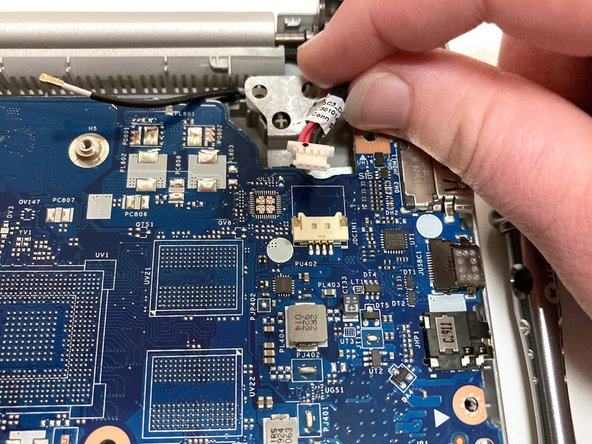

  21. Lenovo IdeaPad S340-15IWL Camera Replacement: crwdns2935265:021crwdnd2935265:01crwdnd2935265:02crwdne2935265:0 Lenovo IdeaPad S340-15IWL Camera Replacement: crwdns2935265:021crwdnd2935265:02crwdnd2935265:02crwdne2935265:0
    • Carefully unplug the black and red wires connected to the upper right corner of the motherboard.
    • These wires connect to the device’s charging port.

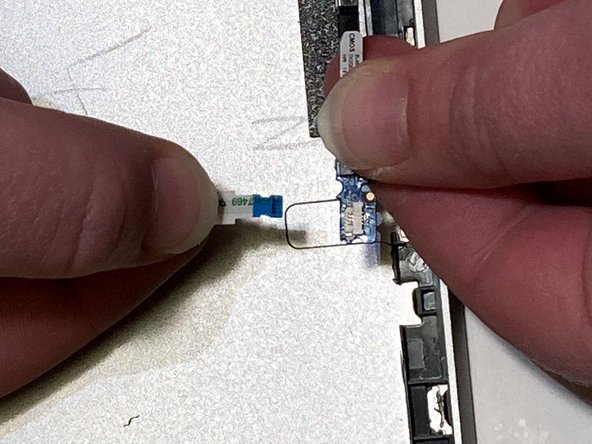

  26. Lenovo IdeaPad S340-15IWL Camera Replacement, Camera: crwdns2935265:026crwdnd2935265:01crwdnd2935265:03crwdne2935265:0 Lenovo IdeaPad S340-15IWL Camera Replacement, Camera: crwdns2935265:026crwdnd2935265:02crwdnd2935265:03crwdne2935265:0 Lenovo IdeaPad S340-15IWL Camera Replacement, Camera: crwdns2935265:026crwdnd2935265:03crwdnd2935265:03crwdne2935265:0
    • Under the device’s screen, there is a small cable running up the middle of the device which is connected to the device’s camera.
    • Using an opening tool, gently pop the camera off of the two plastic connection points holding it in place.
    • The camera itself is quite small and somewhat difficult to see.
    • In addition to the plastic connection points, the camera is also connected to the casing with a foam adhesive. You may have to pull this adhesive strip off instead of prying it out of place.
  27. Lenovo IdeaPad S340-15IWL Camera Replacement: crwdns2935265:027crwdnd2935265:01crwdnd2935265:02crwdne2935265:0 Lenovo IdeaPad S340-15IWL Camera Replacement: crwdns2935265:027crwdnd2935265:02crwdnd2935265:02crwdne2935265:0
    • After loosening the connection cable from the casing, gently pull out the blue chip connecting the cable to the camera.
    • The blue chip is extremely small and bends easily. Apply as little force as possible while both removing and reinserting it.
