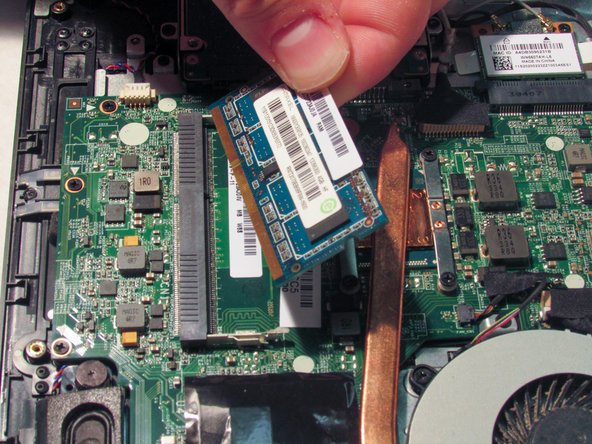

  6. Lenovo IdeaPad S210 Touch System Memory / RAM Replacement, System Memory / RAM: crwdns2935265:06crwdnd2935265:01crwdnd2935265:02crwdne2935265:0 Lenovo IdeaPad S210 Touch System Memory / RAM Replacement, System Memory / RAM: crwdns2935265:06crwdnd2935265:02crwdnd2935265:02crwdne2935265:0
    • Release the RAM from the motherboard by pressing the two locking latches away from each other.
  7. Lenovo IdeaPad S210 Touch System Memory / RAM Replacement: crwdns2935265:07crwdnd2935265:01crwdnd2935265:03crwdne2935265:0 Lenovo IdeaPad S210 Touch System Memory / RAM Replacement: crwdns2935265:07crwdnd2935265:02crwdnd2935265:03crwdne2935265:0 Lenovo IdeaPad S210 Touch System Memory / RAM Replacement: crwdns2935265:07crwdnd2935265:03crwdnd2935265:03crwdne2935265:0
    • After the latches are unlocked, the RAM module will shift so it sits at an angle. Gently pull RAM module at this angle to free it from the socket.
    • When reinstalling, be sure to align the notch on the RAM stick with the slot on your motherboard. Improper installation may cause damage to the motherboard or RAM.
