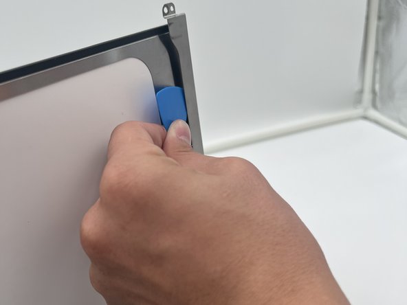

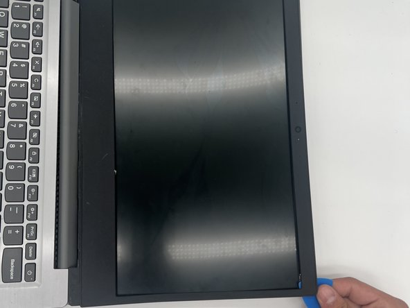

    • Use an opening pick to pry off bezel.

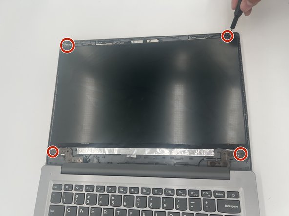

    • Use a Phillips #1 screwdriver to remove the four screws that secure the display.

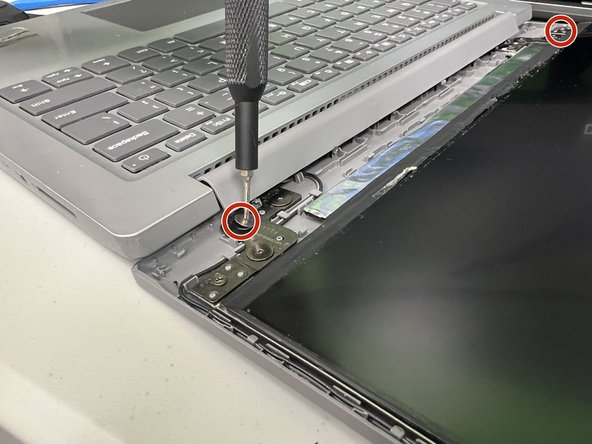

    • Use an opening tool to pry off the hinge cover.
    • Use a Phillips #1 screwdriver to remove the screws securing both of the hinge brackets.

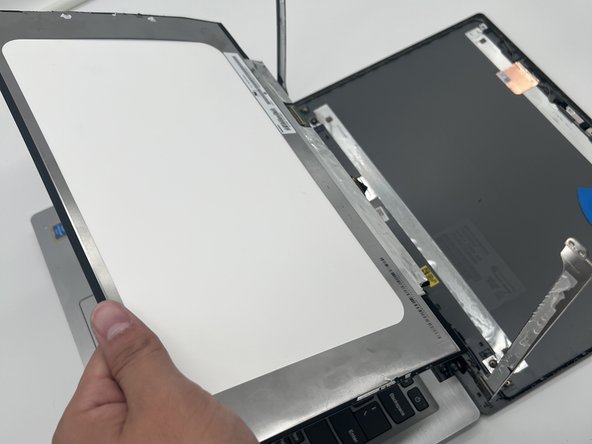

    • Use tweezers to peel back the tape over the display connector.
    • Lift the display connector locking bar.
    • Disconnect the display cable connector.
    • Lift the display assembly up and out.
